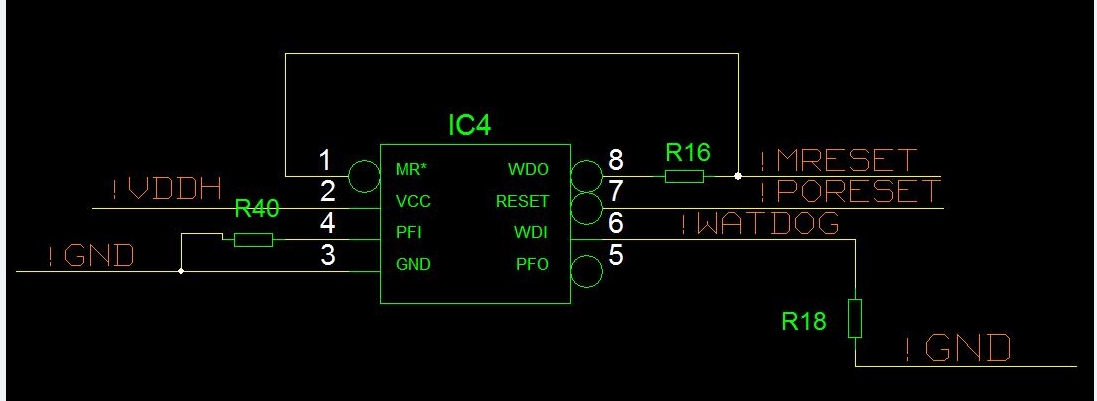

Hi there,
My customer is using WDO to pull down MR to reset the processor itself which stopped feed WDI. In the WDO output, there is a 0.1uF capacitor that prevents  MR pulled low to its threshold to trigger reset. After removing the capacitor, the issue is closed as reset function works as wanted.
However, in this issue with 0.1uF, we saw something interesting. WDO couldn't go low enough to MR threshold, and it was pulled up after a short time. We don't know how it be pulled up, as no WDI signal(always pulled high in last figure) and it couldn't be the internal 14kohm pull-up resister of MR.
I would like to if there is other mechanism to pull WDO high.

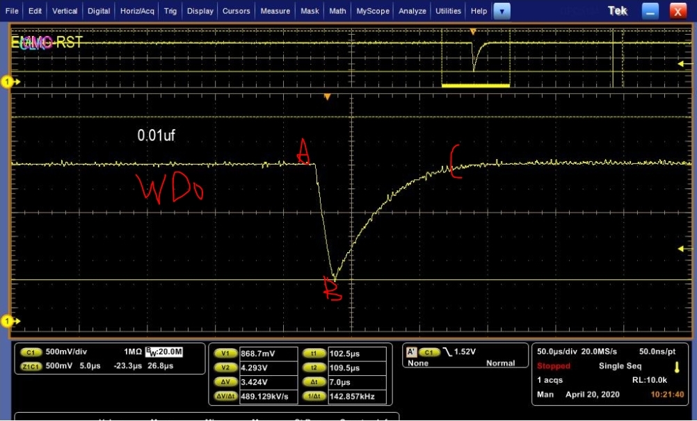

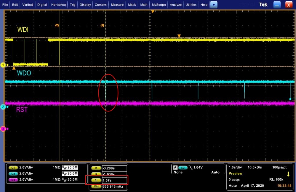

  • Hi Abhinav,
    You could see in the second figure. WDO was pull low from Point A to B then return to high(Point C). In the third figure, you could see the time interval between each WDO spurs is 1.6s, which is exactly the watchdog response time. But, there is no WDI signal to change the WDO status. It would be something internal to pull it back to high then repeat the some action after every 1.6s.

  • Hi Abhinav,
    In Figure 3, WDI shops toggling and remain high, at this time , there are spurs in WDO. Zoom in the spur in Figure 2, you could see WDO doesn't go low enough to MR threshold then pulled up by something unknown. It happens only when the 0.1uF cap presents.
