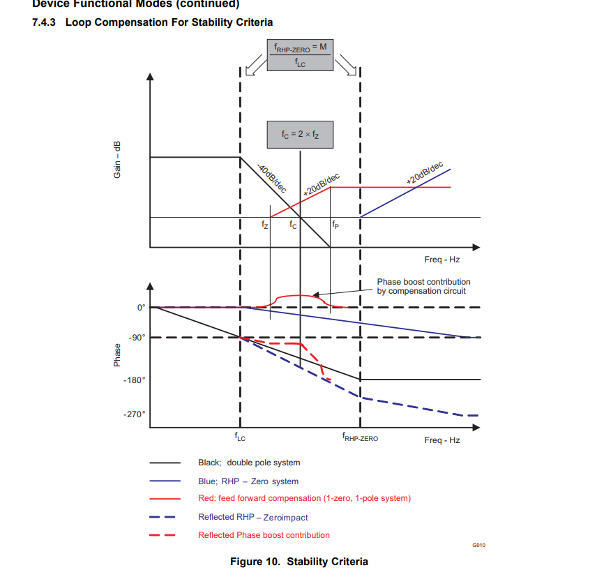

Could you tell me how we calculate and modify C10 and R10 value for loop stability in TPS55332EVM datasheet?
I added large input capacitor (for Vbat) and large output capacitor (for Vout). Then TPS55332EVM does not work and COMP pin oscillated. I guess it is due to loop stability.
