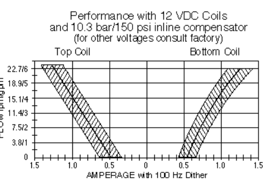

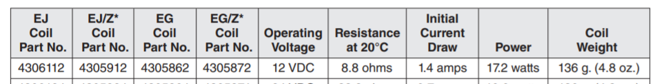

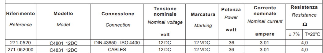

  •  The actual system work with 2 types of valves, one of 1.2A and other with 3A.
    It uses a discrete low side with 1KHz of PWM for 1.2A and a lower frequency for 3A valve.
    The current monitor is done with a shunt resistor and a current sense amplifier.
    1- 1.2A Coil Valve
    2- 3A Coil Valve
    I'd like to do the current control with a high side, max current of 4A.
    I appreciate your recommendation.
    Thank you
  • Hi Leandro,
    Thanks for the information. If you have just one channel at 1kHz, this will do much better. You'll be able to work with the TPS2HB35-Q1 devices with your 3A valve at 90Hz with your 1.2A valve at 1kHz if you need the 4A limit
    Another device that could work is the TPS2HB16 if you're ok with a typical current limit of 4.1A. This'll bring your frequency on the 3A to 400Hz.
    These recommendations are based on calculations you can find in this app note and assumed an ambient temperature of 105C. If you have more information about your load conditions such as ambient temperature that the device will be operating in, I can adjust the calculations for you.
