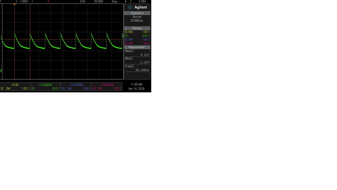

my customer is using PMIC TPS65218 in their application and it was running well. He switched to the new TPS65218D0 now and got into a problem which stopped the production!
The problem is that in a specific configuration when the application is switched off still a parasitic current occurs on the BIAS and DCDC input terminals of the PMIC (see attachment). Now the D0 PMIC is going into the OFF state after a period of 1-20s and states there, no chance leave this state. Only the push button or a reset helps. The non-D0 version wasn't going into this OFF state.

  • Holger,
    Sorry, but what am I looking at in this scope shot? What pin are you probing and when are you probing it?
    I don't really have a point of reference here. It would be nice to see PWR_EN pin and at least one DCDCx output voltage in the same capture.
    If you are saying keeping DCDC5/6 on helps, it would also be helpful to show DCDC5 or DCDC6 (a) when you are experiencing the issue, and (b) when there is no issue. Please use all 4 channels on the scope to provide some context.
    Leaving the OFF state depends on 4 events: VIN_BIAS > (VUVLO + hysteresis) & (PB low || AC_DET low || PWR_EN = high)
    In order to determine if the issue you are seeing is expected behavior, I need to know the state of these 4 pins at the time when you expect the PMIC to turn back on.
