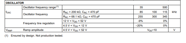

TPS40200: Switching frequency variation?
Part Number: TPS40200
Team,
We are using the TPS40200DRBT in a current design (36V to 12V buck converter application), and I have a question about switching frequency variability.
I have R_rc set as 60.4k and C_rc set as 330pF.  The output is stable at 12V, but the switching frequency is ~ 406kHz (I was expecting a switching frequency closer to 477kHz).  How much variability can I expect when setting the switching frequency with this part
