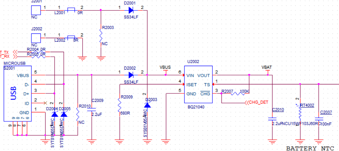

Hi
For the abnormal charging current describe as below:
1. VBUS = 5V, VBAT = 3.13V, charging current 615mA, the charging current in the constant current stage has not reached the design value 800mA.
2. VBUS = 5V, VBAT = 4V, the charging current starts to decrease, and the constant voltage stage is not entered at this time.
3. VBUS = 5.3V, VBAT = 4V, the charging current is restored to 800mA, what is the requirement for VBUS input voltage to maintain the maximum current charging?
The voltage and current test data are as follows:

The Schematic as below:

    At low VBAT, the voltage drop within charger is highest, so charging may not be reaching 800mA due to hitting thermal regulation. At higher VBAT, it could be limitation of the VIN to VBAT drop which could be causing drop in current. The charger needs enough headroom for best performance as the battery voltage goes high. Typical dropout voltage for charger is 325mV at 500mA charging. Dropout at 800mA will need to be even higher than this.
    What is BQ21040 VIN pin voltage during these tests? I suspect it is lower than 5V as there are diodes in input path.
