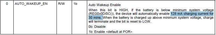

Could you tell me about AUTO_WAKEUP_EN?
If the charging current is changed when the AUTO_WAKEUP_EN function is activated, which current has priority?
(Charge Option 0 is the default setting status.)
The host can overwrite the charge current to 250mA and take the priority.
