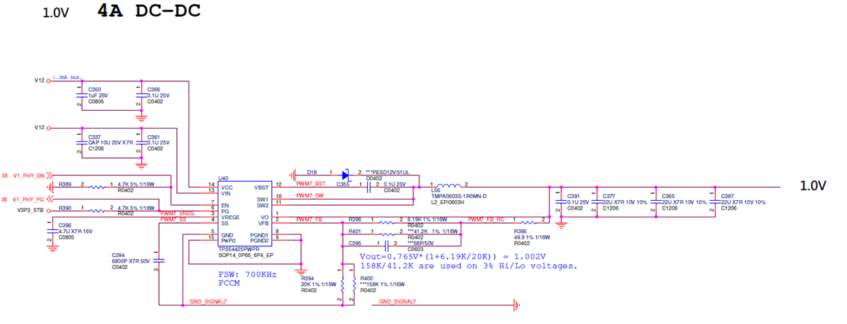

Part Number: TPS54425
The equipment we use is as follows ~~

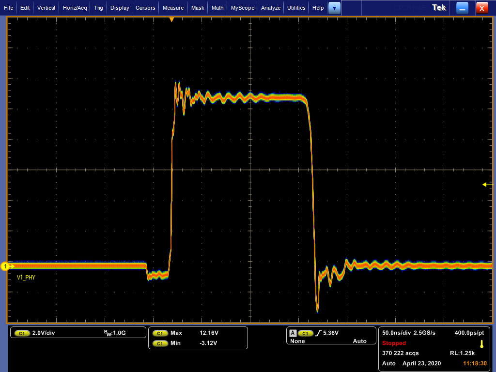

Tektronix P5205A-2 High Voltage Differential Probe 100MHz 50X Bandwidth no limit
Oscilloscope: Tektronix DPO5104B 1 GHz digital 4 ch Bandwidth: 1GHz
Kao,
That is barely measuring past -3 V. The most accurate measurement will require a differential probe. I think you will find that if you measure it properly with a differential probe, the negative excursion will be well within specification.
HI SIR
Kao,
Typically, a resistor in series with the bootstrap cap is used for the EMI improvement by slowing down the slew rate of the highside mosfet. Here you can use the 3.3 ohm resistor of course.
HI SIR
Hi Kao,
Both of the above methods are useful as long as the solution cost is acceptable for your customer.
