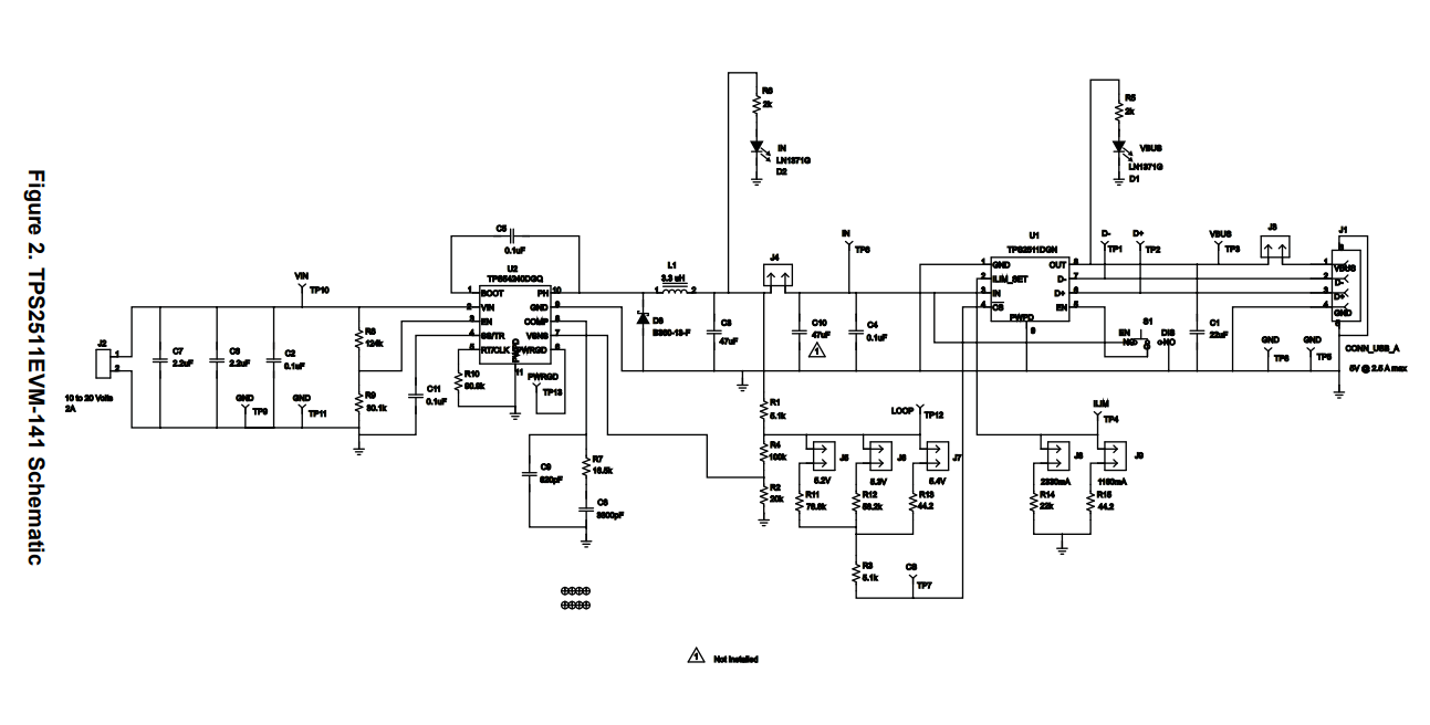

TPS54240: Snubber Circuit to reduce EMI
Part Number: TPS54240
I utilized the TPS2511EVM-141 components and layout in a design with a BLE connected device and the Circuit is failing radio emissions testing due to EMI created by the switching regulator, TPS54240
We have high frequency ringing around 180MHz.
I would like to know if there are any recommendations for a snubber circuit or any kind of filtering for use with the components and respective values in on the EVM board that will effectively reduce ringing on the output of the TPS54240 and minimize EMI so we can pass our EMC testing
 See attached Data sheet, schematic on PG 4. 5516.TPS2511EVM-141.userGuide.pdf
