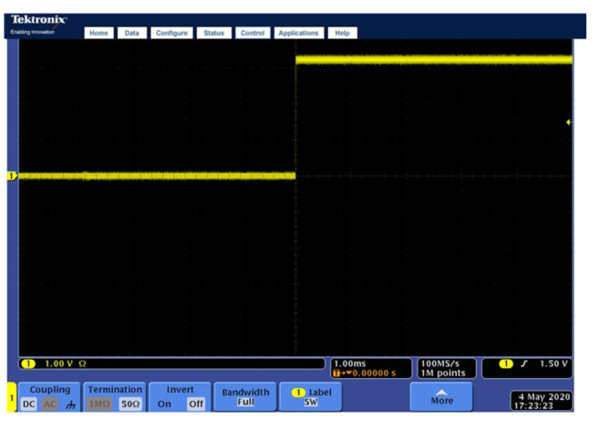

  • Hi Peter
    I already have checked Power Good waveform in TPS53915 datasheet, I saw that there is no noise on Power Good signal with bandwidth of probe is 20Mhz. I tried this one on my board and saw that the power good is lose noise. But If I changed the bandwidth of probe to 250Mhz or 500Mhz is appearing noise. Could you please explain the different between selection bandwidth of probe? Why did you measure the signals in the bandwidth 20Mhz?
    I attached the picture TI's waveform and my waveform in below
    Thanks you so much
    Tuan Le
    Oscilloscopes have the ability to apply a bandwidth filter on their input signals to reduce very high frequency noise that can be picked up by their high-bandwidth probes.  The frequency is the 3dB (half-power) point of the single-pole filter.
    We routinely select a 20MHz bandwidth filter when measuring low-band width signals for generating oscilloscope waveforms to remove induced measurement noise from the images to make them more readable.  Oscilloscope ground clip loops, multiple ground connections on the PCB, especially when measuring a highly dynamic signal like SW that is switching from 0V to 12V in a few nanoseconds, can induce a lot of measurement noise, selecting bandwidth limiting removes these artifacts from the signals and makes the signals of interest easier to read.
    In the case of PGOOD, when the PGOOD signal is low, the PGOOD pin is shorted to GND inside the TPS53915 with a low-resistance FET, so PGOOD is tracking the ground of the TPS53915.  This ground has a lot of high-frequency noise on it with respect to where you connected your ground clip because the GND is also carrying a lot of dynamic switching current from the Power FETs, so when it's low, you see noise on it, but once the pull-down FET is released to be pulled, you don't see that noise.

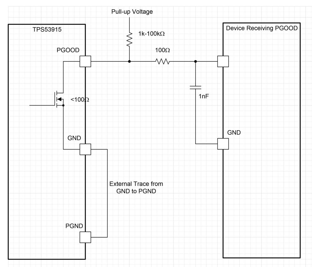

    So now, could you help me to find any solutions or workarounds for increase impedance between PGOOD pin and PGND on TPS53915? and I'd like to request more documents or errata which one show lower impedance will cause the noise on PGOOD pin. Please send it to me.
    One more things, could you please suggest an alternative part for TPS53915? we hope that they have pins compatible.
    Tuan Le
    The low impedance of the internal PGOOD pull-down MOSFET and low impedance from the MOSFET's source to the power ground of the TPS53915 combined with the very low output capacitance of the PGOOD pin causes the PGOOD voltage to follow the PGND of the TPS53915 very closely.  While this ensures the lowest possible voltage at PGOOD with respect to PGND, it can allow PGND noise to appear on PGOOD.
    The most common technique for filtering PGND noise on PGOOD is to add a small series resistor to the PGOOD signal with a bypass capacitor local to the receiver of the PGOOD signal.
    There is no alternative part to the TPS53915, nor is this a "bug" that requires an application note or errata.  The PGOOD function is working, the issue is differences between the ground voltages at the TPS53915 and the receiver it is being monitored at.
