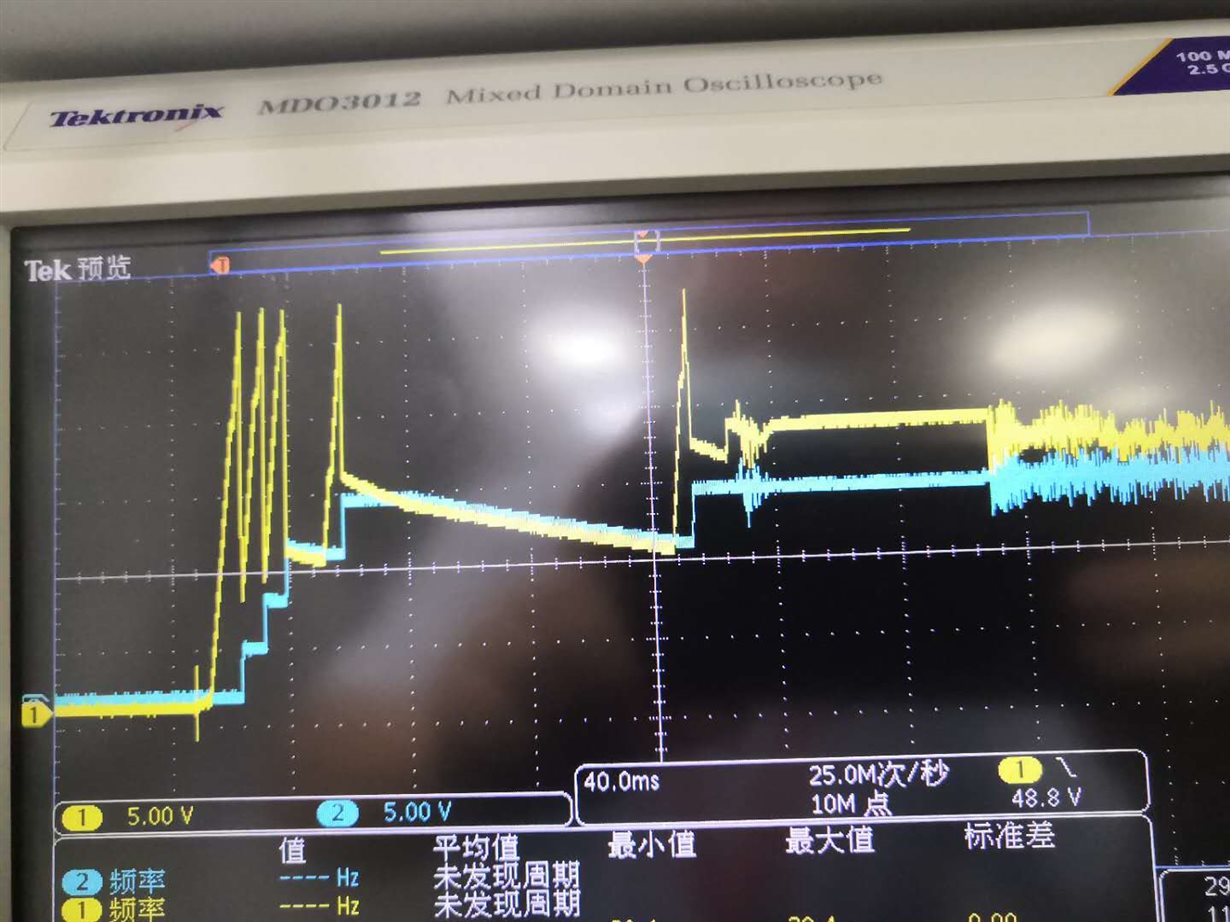

    1、 yellow show Vcc waveform;Blue show Rvcc waveform; Vcc  capacitor voltage is fast  discharging;What caused the problem; how to resolve the problem

    When the UCC256402 sees a fault such as over current or over voltage it will stop switching  and VCC will cycle between VCCstartself (26V) and VCCRestartJfet(9.65V).
    Your design when it comes up is hitting a fault.  RVCC does not seem to have time to charge up during the faults.
    Consider rechecking your designs VCR, ISNS and BLK dividers with the excel tool to make sure they were selected correctly.  If the BLK divider was setup incorrectly and the LLC is starting up at too low of a voltage it could also contribute to excessive current during startup.
    You can also double check these signals with an oscilloscope along with the VDD and RVCC pins as well.  To try to figure out why your design is shutting down.
