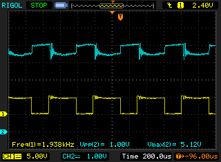

    It may be that our circuit is getting into a state where the PWM varies due to effects on Vss by the LM3410, causing a feedback loop.  In other words, Vss noise causes our microprocessor to adjust the PWM to less than 100% (full on), which causes Vss noise.  (Ground is measuring dead-flat zero, BTW, so it isn't a scope loop.)
    I've taken a scope trace of the 2 kHz PWM being sent from our microprocessor to the LM3410 at roughly 66% duty cycle, and the subsequent impact on Vss.  The yellow trace is the PWM signal. The blue trace is Vss.  Note that scales for the traces are different (Vss is shown at 1V per division to illustrate the impact better).  Vss is varying about 1Vp-p.  In this case, the "noise" is effectively ringing and power supply droop from what I can tell.

  • Hello Basso,
    This is caused by impedance from the power source to the input of the LED driver.  If the output is 9V at 300 mA the average on-time input current is above 600 mA for 4.4V input (during the LED on-time).  It appears to be dropping about 0.6V which makes the input impedance around 1 ohm, this is high.
    To hold this up with capacitance it will require 1800 uF of capacitance to keep the dv to around 0.1V.  I would look at reducing this impedance since the dv will go up as the input voltage goes down.  You can try adding a large electrolytic capacitor to the input to see if it reduces this.  You have to keep the ceramic for high  frequency bypass.
    How is the power supply connected to the LED driver?
  • Irwin:
    Thanks, that's likely where we need to look.  We have a power supply MOSFET between the power supply and the driver, and although it shouldn't increase the impedance much, it's not helping. The extra long cord to our power supply is probably the major contributor.
    We're going to see if we can put the battery permanently inline with the driver so it acts as a large (although not wagon-filling) capacitor when wall-powered.
    At this point, I think the problem lies outside of the LM3410.  I appreciate you walking through this with me.  It's a great help to have you available for questions!
