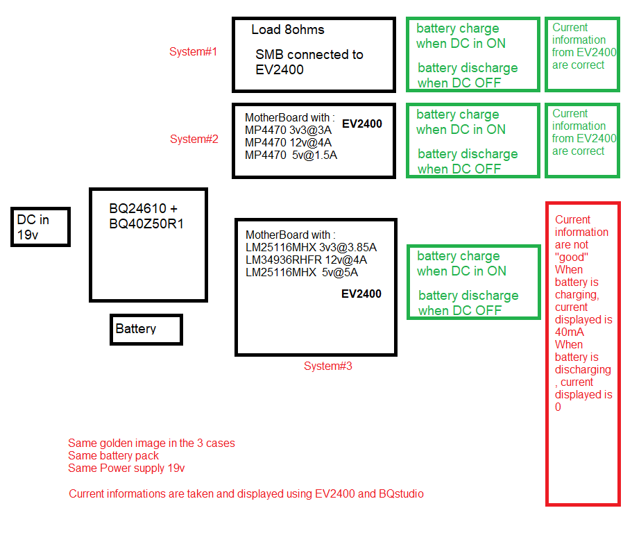

I made a drawing of the strange case we get on a BQ40Z50R1 + BQ24610 design.
We have 2 version of MotherBoard using 2 types of power architecture to generate 3v3, 12v and 5v
One of them (our new motherboard design) have a strange behaviour when reading data from BQ40Z50R1.
Charging and discharging the battery works well, system is correctly powered from battery but the data read from BQ40Z50 are not relevant
Using EV2400,
Current displayed = 0 when battery is discharging (remenber: battery powered correctly the system)
Current displayed = 20mA when battery is charging. (remenber battery is correctly charged after 2 hours)
and others parameters are also not relevant :
For example : 'time to full' is very long (because current charge is 20mA)    But in real , current charge is 1.6A
I can provide schematics of the 3 systems
Any idea to help ?

  • In the association od BQ24610 and BQ40Z50, it seems that B24610 works correctly
    BQ40Z50 don't 'see' correctly the current deliver by BQ24610
    In term os system.
    We have old system where "BMS + Battery" works correctly when connect to 3 x MP4470 step-down
    Our new system where "BMS + Battery" does not work correctly when connect to 2 x LM25116 and 1 x LM34936
    By 'Not Working Correctly" , i mean information read from BQ40Z50 are not the value seen into the system
    If you compare solution based on MP chip and TI chip, that type of phenomena can produce this ?  self, resistance, impedance, LC, RC, other ?
    Gilles
  • Hi Gilles,
    If my understanding is correct,  the same "BMS + Battery" works well with System #1 and System #2.  Your problem occurs when System #3 that uses different buck and buck-boost controllers is connected.  Correct?
    I'm not the expert on the buck or buck-boost controller. I suggest you may want to check with the TI expert on these devices since the issue is related to the System #3 board.
