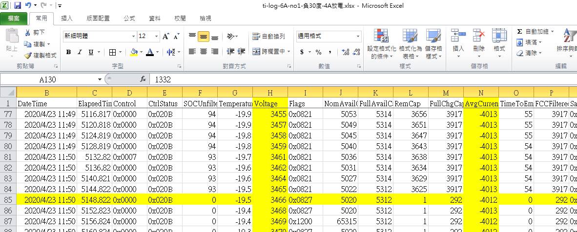

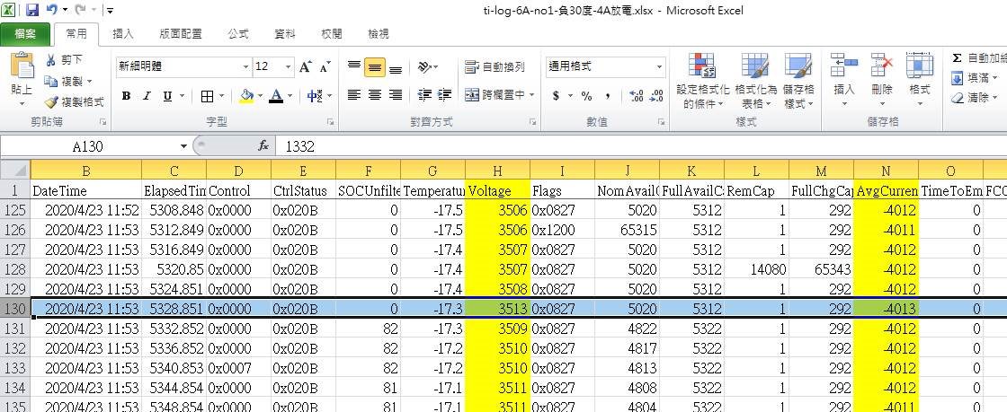

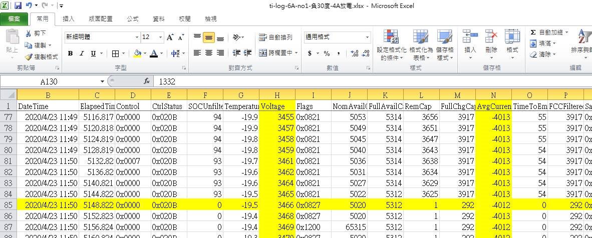

2. We used the TI EV2300 kit to capture the discharge LOG during the test of the battery low-temperature discharge curve and saw that the State Of Charge parameter suddenly changed from 93% to 0% after six minutes of starting discharge.
Then after three minutes, it changed from 0% to 82%.

    The battery we chose is a battery for low temperature applications. From the discharge curve given to you before, it can be seen that the PACK is at -17 degrees and 82%. When the current is discharged from 4A to 0%, it can also be discharged for 1hr, which is equivalent to 4000mAhr. 72% capacity (total capacity 5500mAhr).
    Only from 100% to 82%, there is a sudden drop in capacity to 0%, and after three minutes, it will return to 82%. This situation will make our system think that the battery is really 0%, and then enter the shutdown mode. Please help analyze the reason why this situation occurs, we see there are ways to avoid it?
