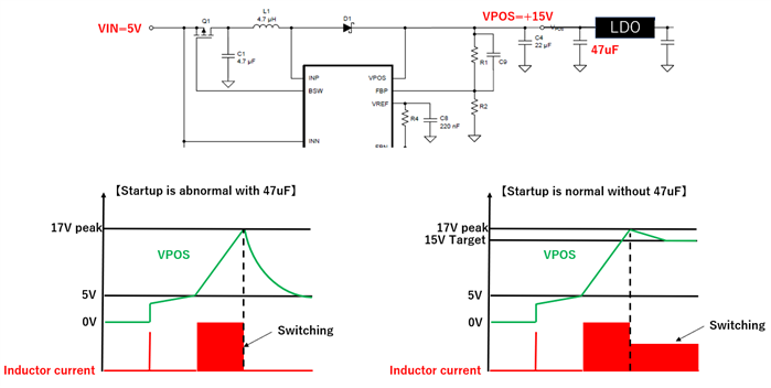

Could you please let us know the maximum output capacitor value?
We understand that Output capacitor is “4 x 4.7 uF, ceramic, 25 V, X7R” in Typical Application.
However, we would like to add 47uF of VPOS output capacitor because Input capacitor of LDO is connected behind VPOS.
[Q2]
We are evaluating TPS65131 at VIN=5V, VNEG=-15V, VPOS=+15V, IOUT=around 100mA.
-If VPOS output capacitor is “4 x4.7uF”, VPOS startup is normal.
-If VPOS output capacitor is “4 x4.7uF + 47uF”, VPOS startup is abnormal (Switching stop.)
We guess that abnormal startup issue is output capacitor value.
However, we can't understand the mechanism of problem occurrence.
Could you please let us know if you have any concern?
