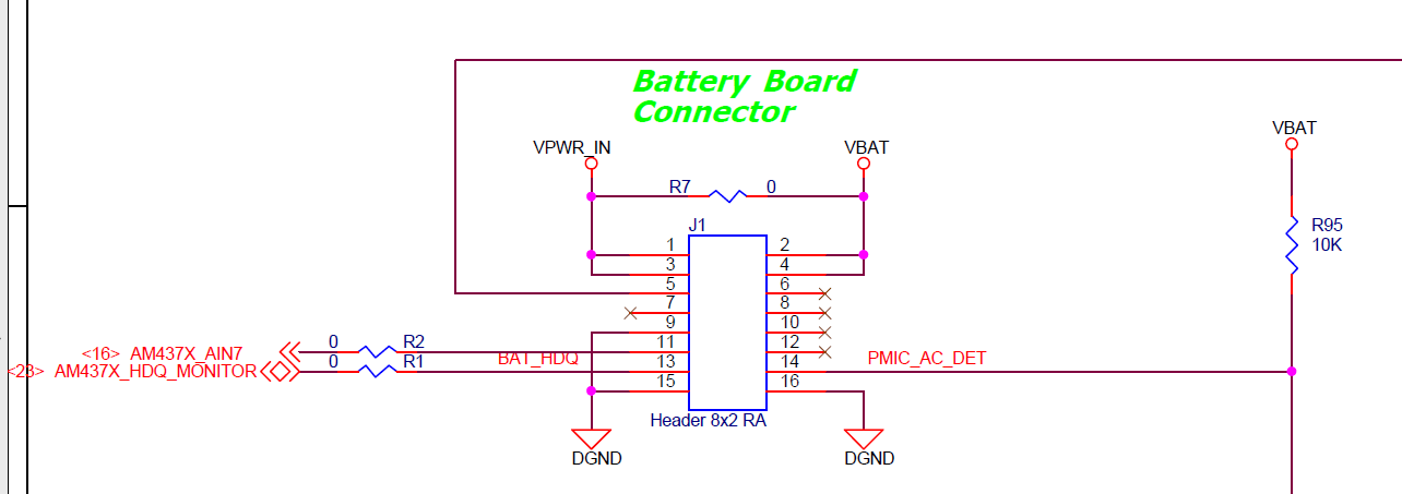

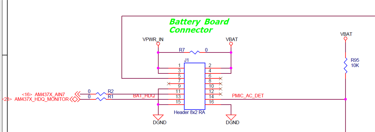

The TPS65218D0RSLR PMIC does have one buck-boost converter inside it (DC-DC 4) which can generate 3.3V output even when the input supply is less than 3.3V. Knowing this, we were planning to supply the PMIC directly from the single cell battery power which would range from 3.0V to 4.2V.
Can you please confirm if AM437x EVM platform is tested with single cell battery supply directly provided to the PMIC?
