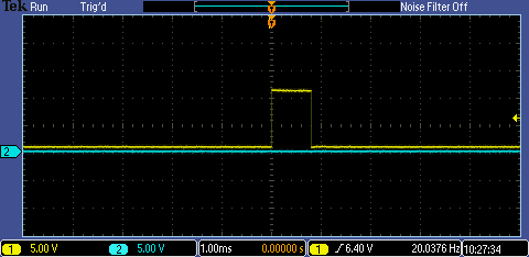

EN1 ==> it is a pulsed signal, duration of 800 us and about 20 FPS

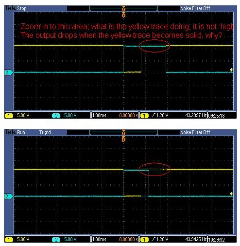

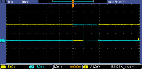

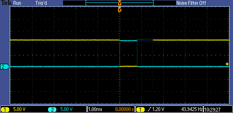

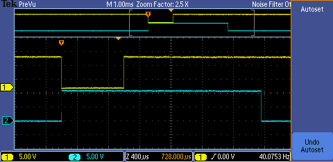

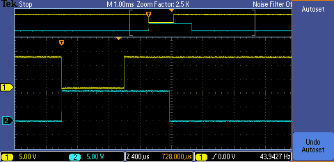

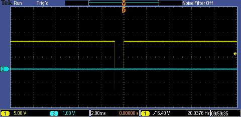

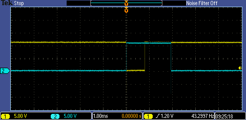

However, I have some unstabiity in the output time, which should follow EN1 (Second image is EN1, first image is a reverse signal previous to EN1 called pulse1, for practical reason I will show most of times pulse1):

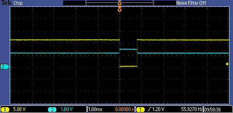

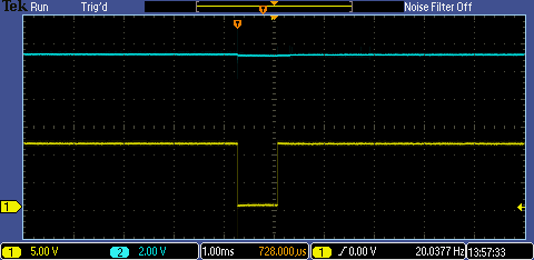

Signal is stable an clean. but when I probe sal1(blue), I have a signal that oscilate between 800 us to almost 2 ms attaced is shown some screenshots in the oscilloscope.
Honestly dont know what could happen. Maybe too much current?
  • Hello Ramiro,

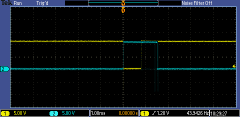

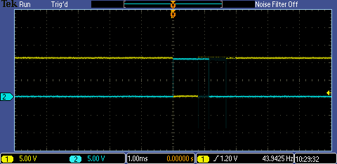

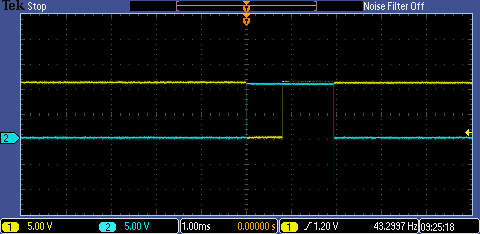

    Is your command oscillating?  What is Vin doing during this time.  I assume that the yellow trace is the command per the first two pictures, one inverted one not.  Are the last three pictures in the same order, yellow is command and blue is output?  It seems the input voltage and LED voltage are almost the same, this may cause strange behavior.  Also, can you get a clearer picture of the oscillation?

  • Hello Ramiro,
    WIth Roff at 1.1 Kohm the off-time with 11V output is only 65 ns.  Depending on how much overhead voltage, or if there is any at all the switching frequency range can be very large.  I also get inductor di/dt of 0.237A.  This means the average output current will be 2.34A since the peak current threshold is 2.46A
    Have you looked at the switch node during this operation?  Is it even switching or is the MOSFET just turning on?

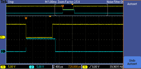

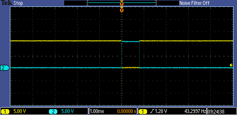

  • Hi Irwin,
    You are right about yellow trace, is the command signal.  and, despite the quality of the picture, is all the time 800 us wide. However, output blue trace change the wide: output is 1800, 1500 and 800 us (third, fourth and fifth picture ) depending just on the different moment my finger push the save buttom at the oscilloscope :(. It is oscillating all the time

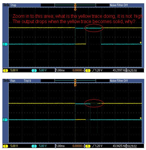

  • Hello Ramiro,
    Yes, I would make Roff a larger value, try 4.7 Kohm, that will drop the average to just below 2A at 1.954A calculated
    I don't understand the oscilloscope pictures.  I see the inverted command high and low however there is a portion that I cannot tell what it is doing.  During this time the output is either on or off (off in picture 5 and on in pictures 3 and 4), the two that are on line up with the portion of the yellow trace which cannot be seen in the picture.  I cannot tell if this is a command issue or something else.  Also, since this is the inverted signal perhaps the UVLO signal looks different during this portion of time?

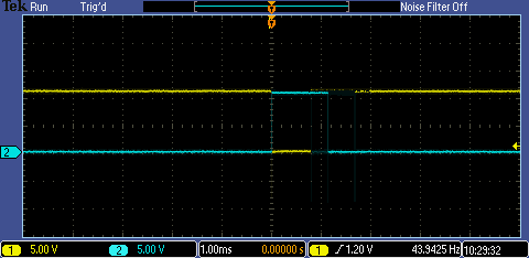

    Here you have some clear pictures (I hope). Yellow trace is EN1 inverted(it is actually a previous signal), starting always at 0, ending always at 800 us . Blue is output, which should follow EN1. As you can see bue trace it´s oscillating all the time while inverted EN1 is correct wide always
    On the ther hand , In the next picture you can see in blue UVLO,
    I will try to change Roff to see if there is any difference
  • Hello Ramiro,
    Move your scope trigger to the left and change the time base to get more of the waveform on the screen.  Also make sure the scope sweep is a single sweep otherwise you don't know what you are looking at.  Roff will most likely not change this behavior.

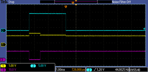

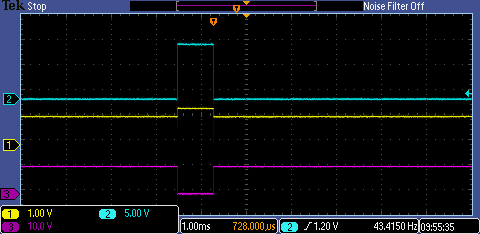

  • Hi
    The Mosfet is turning on and off, so its switching the current. I have not a current probe, but I can see the LED switching all the time, so current is being passing trhough.
    Hi have look at UVLO agains output, and maybe this clear what is happening. Yellow trace: UVLO. Blue trace: output, pink trace, enable signal. If you look at the pictures, UVLO is not  always turning off completly when the enable signal is off.
    First picture: output follows the UVLO signal, which follows enable signal
    First picture: UVLO dont follows enable signal. UVLO has 360 mV between low and high level, but now appears a not desired level of 120 mV before going tottall down, that allows the mosfet to be switched during some ms more (until UVLO goes down at low level)

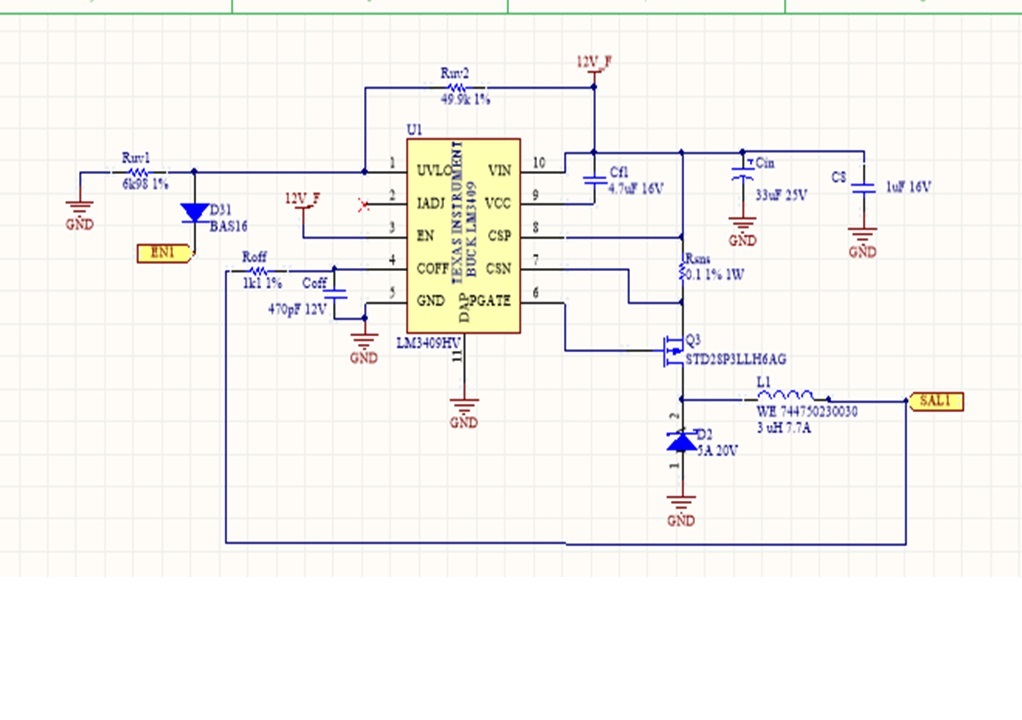

  • Hello Ramiro,
    What is the circuit driving the UVLO pin?  UVLO has a 22 uA hysteresis current source.  It appears there is significant impedance in the circuit pulling EN1 low.
  • Hello Ramiro,
    22 Kohm is not enough to pull the UVLO low.  There is a resistor divider for UVLO on your schematic.  You have a node with Ruv2, Ruv1, R3 and 22 uA of hysteresis current as well as a diode drop from D31.
    I calculated the voltage at that node assuming 0.5V drop on D31 and came up with 1.36V which is higher than UVLO shutdown threshold.  R3 needs to be quite a bit lower for this to work.  Seems like an NPN pulling to gnd would be better.
  • Thanks !
    Lowing R3 to 10k solved my problem. You are absolutly right.
