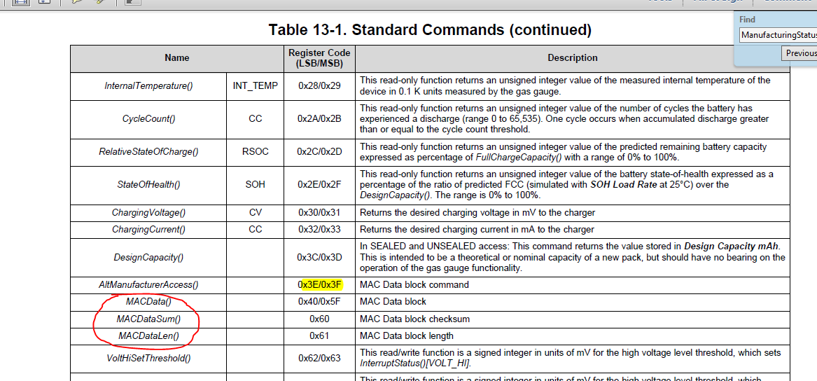

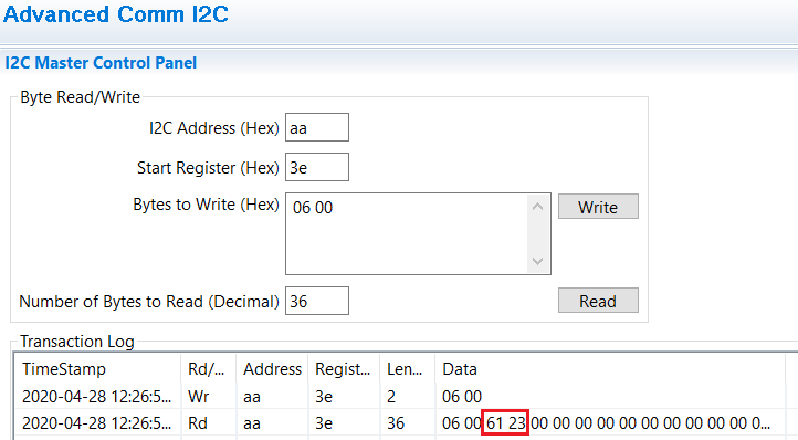

Now when reading block contents of 0x3E, such as 0x0006, the value read out is 43 12, which is inconsistent with the 10 12 provided by the official website. In addition, when reading block data, the clock frequency of IIC cannot exceed 10KHZ, and data will be disordered if it exceeds 10KHZ
