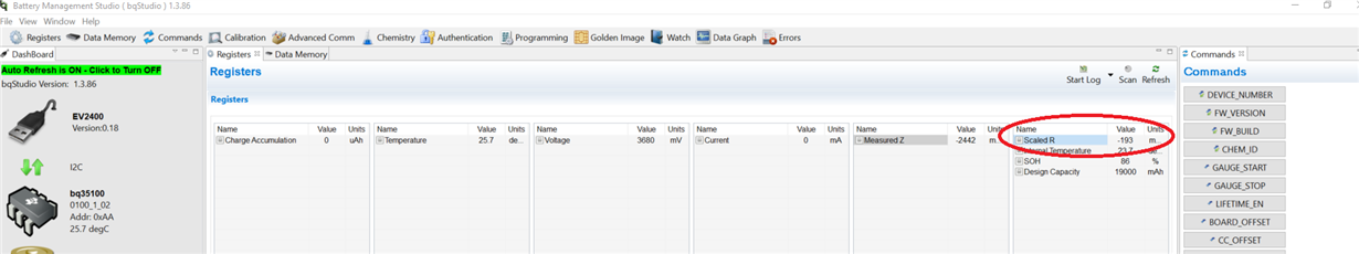

Dear Sir/Madam,
I tried to read Scaled R value and saw that it was almost negative value. And it seems not stable such -193, -2211, -65536.... while not using battery
What does negative value means? is it right?
Using battery EVE model ER34615 19Ah, CHEM ID= 0x0615
KPK

  • KPK,
    If you do not have a battery attached then the gauge has no correct voltage reference to use which will result in bad values being fed into the filter. You will result in an impedance based on the current you measure with no voltage drop. could result in a negative value
    When you do connect a battery you need to follow this procedure
    1) GE high
    2) Gauge Start Command (wait got [GA]=1)
    3) Apply load (This step should cause at least a 100mV battery voltage drop)
    4) Remove load
    5) Issue gauge stop command (Wait for GDONE, 15Sec by default)
    6) Read parameters.
    If your current is not high enough or you do not get enough of a voltage drop you could have issues with the math inside the IC.

  • Thank Erik,
    The lastest picture is I plugged battery already. What does ScaleR negative value mean?

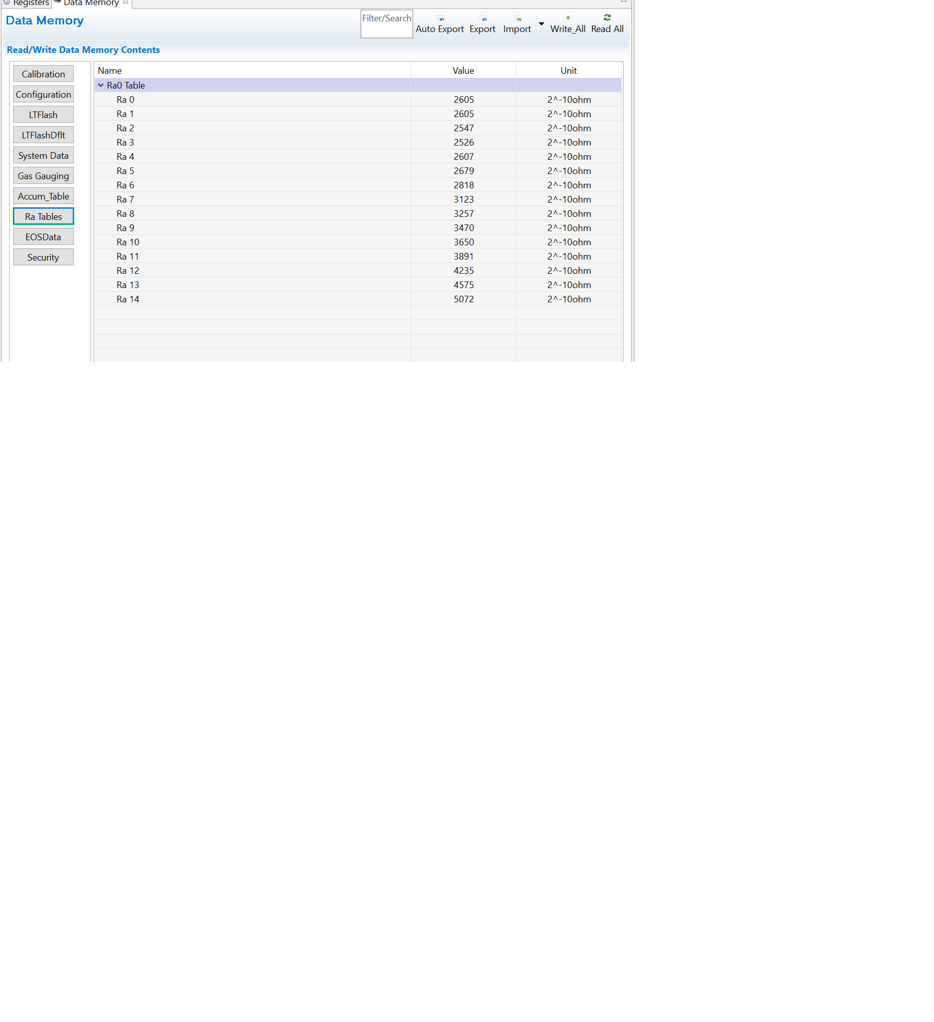

    4. After load chemical ID to BQ35100. I saw Ra Table as below
    It mean when read Scale-R > Ra 14 (5072) then battery is flat? Or we need get this value from step in question 1?

    4) The image did not show up so i am not sure. In general Ra0 is battery full, Ra14 is empty. But they are not evenly distributed. They get closer as you get more discharged
    Eric Vos
  • hi Eric,
    Here is the snapshot that Tuyen is missing out:
  • Tuyen/Poh Kok,
    This particular ID does need to have a very flat profile. I am not sure SOH will be the best judge. This battery seems like the main benefit from it will be the EOS (End of Service) alert when the battery is near empty.
