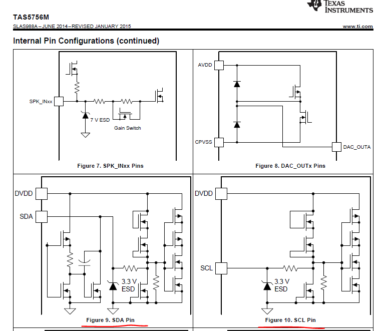

    Regarding to question 1, please help to double confirm with designer and give us the feedback ASAP, as customer is requesting for this urgently.
    For question 2, we need the block diagram similar to other devices like TAS5756's datasheet description as below, please help to provide it.
    Thanks.

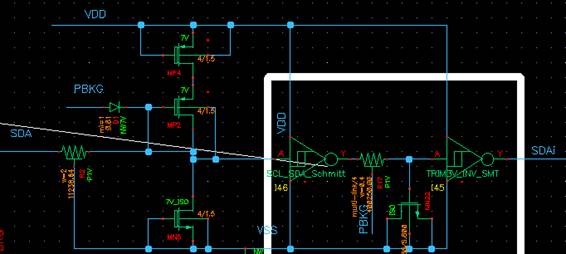

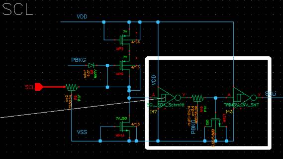

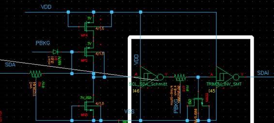

  • Hi, Jacky
    Q1, the answer is yes, there is a Schmitt Circuit for for noise suppression.
    Q2, SCL and SDA diagram as below, FYI.
