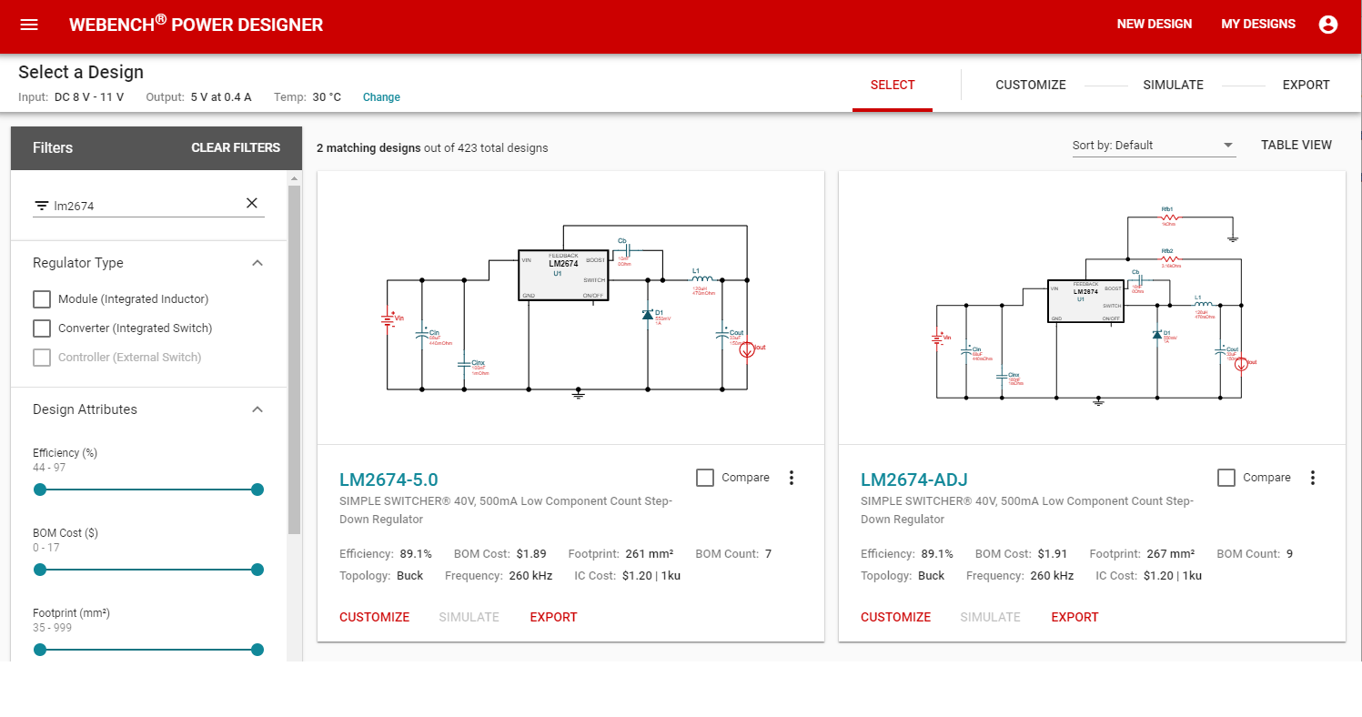

  • Hi Andy,
    When launch webench on Ti.com, LM2674 is not simulated see attach.

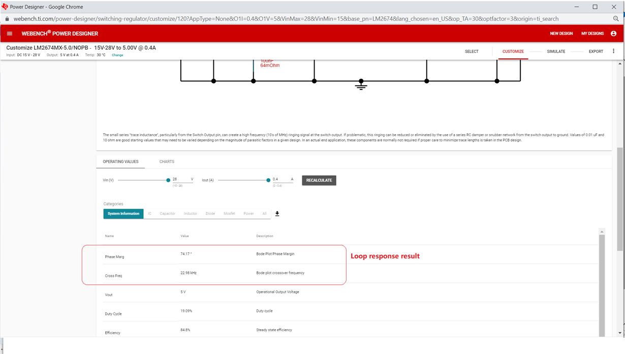

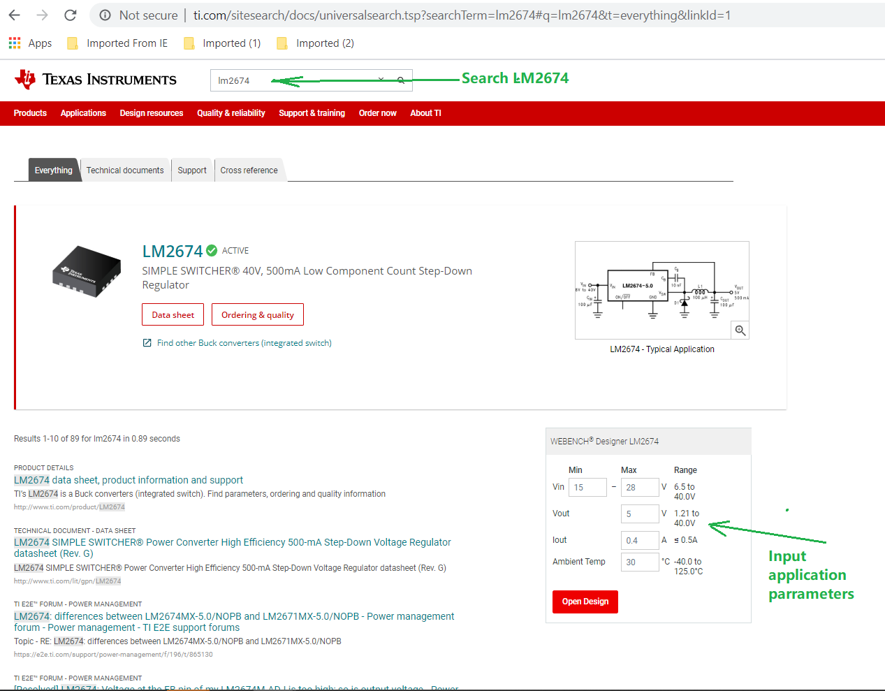

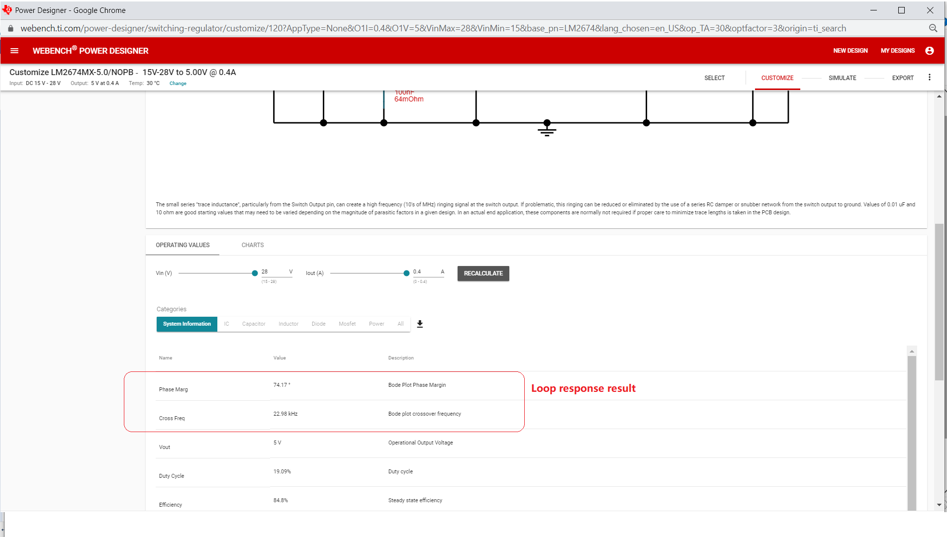

  • Hi Lioni,
    Pls do it as below
    1. search LM2674 on TI Website
    2. input application parameter on Webench Window
    3. Open design
    4. Check simulation result on loop response.
    5. Webench doesn't support transient simulation on this device.
