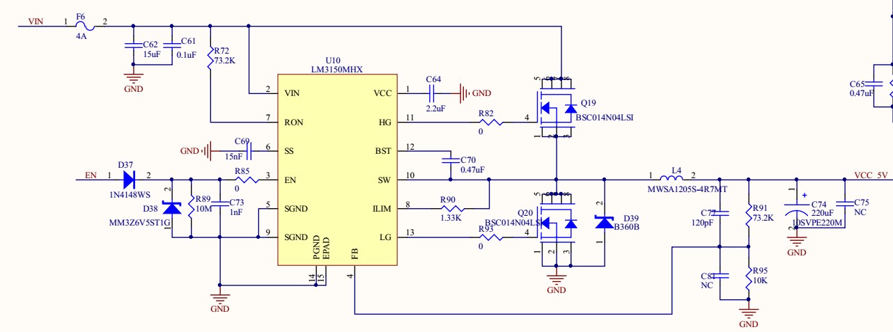

LM3150: In no-load mode, the power consumption is about 40mA
Part Number: LM3150
The output of 5V and 6A can work normally,
But  in no-load mode, the power consumption is about 40mA, and I think is abnormal?
Can you tell me where to adjust it?
  • Hello
    As far as I can tell from the data sheet, this device does not have a specific light load mode.
    That means it will run in full frequency at light load and forced PWM mode.
    So, the 40mA you are seeing may be correct.
    You can acquire an EVM for this device and test it under you specific conditions and see if you get similar results.
    You could try reducing the switching frequency and/or using FETs with smaller gate charge and switching loss, since
    these are the losses that are dominant at light load.
