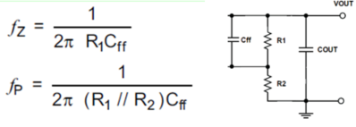

Secondly, there is a table (Table 5) in the TPS568215 datasheet that says a FF cap is not needed for output voltages below 3.3V. The output voltages in my customer's application will range from 0.9 - 2.5V, so I was wondering if there would be any significant benefit to add FF capacitance on these rails, or if the benefits would be negligible.

    TPS568215 doesn't have internal feedforward cap.
    The feedforward cap will induce one zero and one pole as below. So if the Vout is small, the zero and pole are very close to each other which will not promote the phase so much as higher Vout. So the benefits is small.
