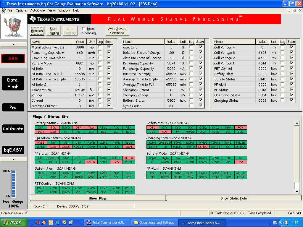

  • Make sure your device is unseal and the voltage is higher than the Flash update voltage parameter in data flash.
    Also make sure you don't have any PF error set. Maybe you can try using EVSW to ensure your setup is good to update flash, and then run your code.
  • Jackie,
    Now the EV2300 screen looks like this :
