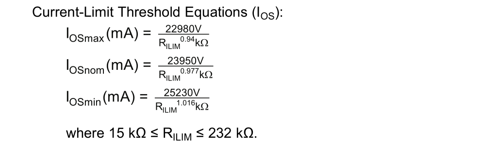

Just want to check with you whether whole temp has been considered in the equation of Ios calculation, that is, Iosmax/min is the worst case at whole temp. Thanks.
