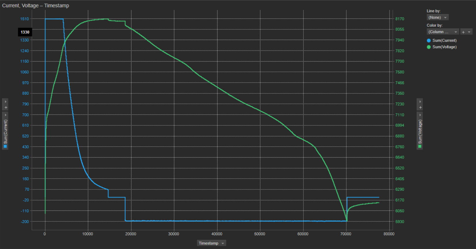

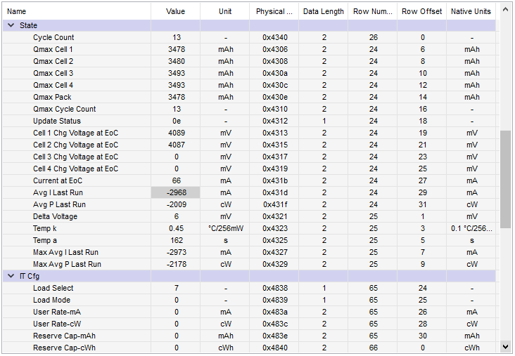

in search of an issue with SOC accuracy I noticed that the parameter
Avg I Last Run (Avg P Last Run) and Max Avg I Last Run ( Max Avg P Last run) in Gas Gauging State Register
are not be updated. Other entries are correct and up to date. I performed the last three cycles at 200mA constant current discharge
and charging at 1500mA CCCV.
Current entries about 3000mA are from earlier measurements.
I want to now what are the conditions to update Avg and Max Avg I Last Run.
Please help.
