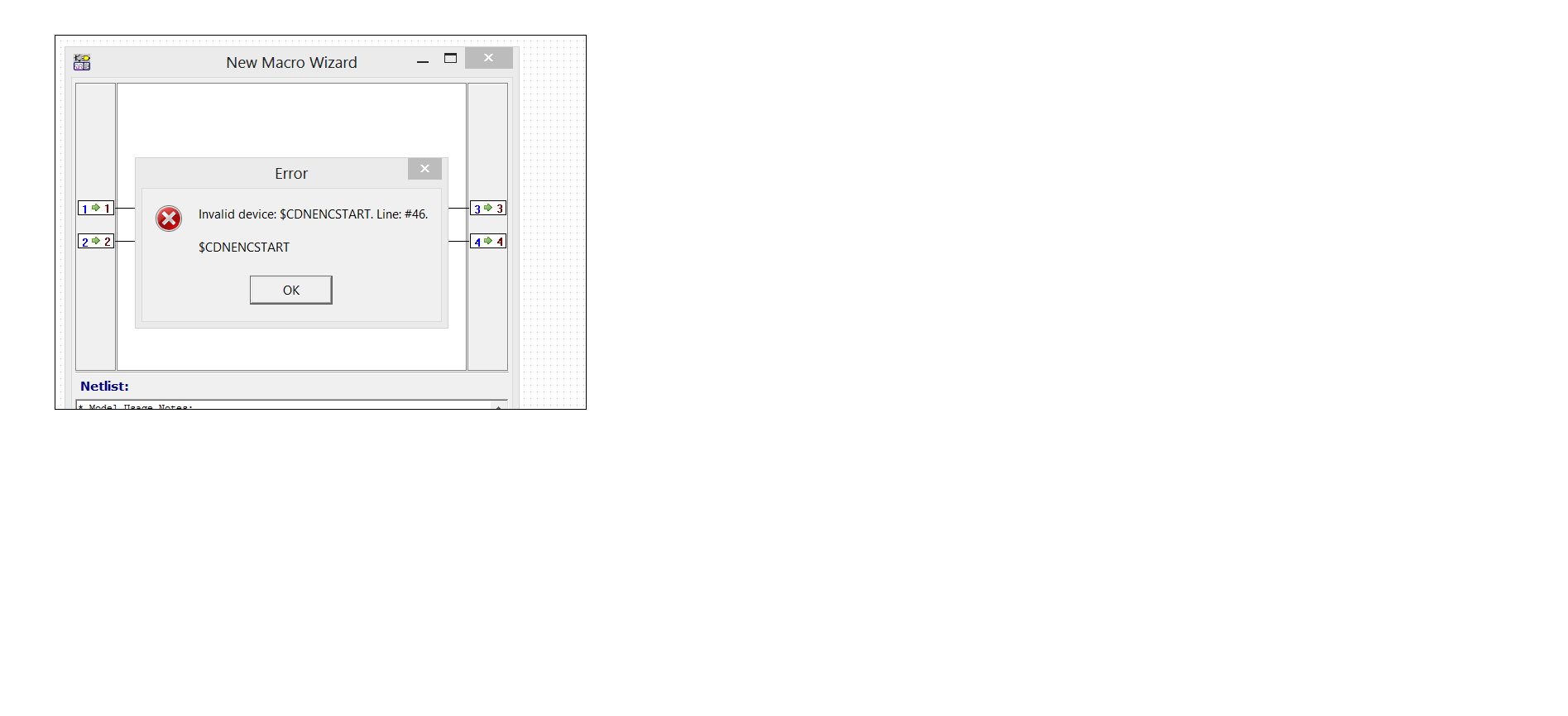

While importing spice model (LM74700-Q1) into TINA TI, am face an error can you kindly help me to sort this out.
I have attached snap of the error which has pop up.

Hi Kishore,
The spice model is encrypted and can not be imported to TINA-TI as such.
We are releasing a TINA-TI model soon.
