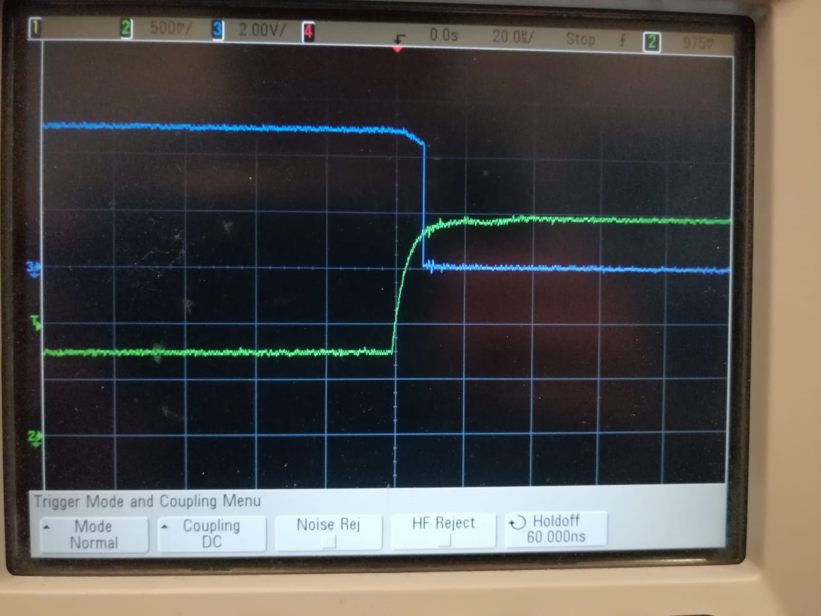

  • hi Qian
    thanks for the reply.
    just found how to attach a pic
    please see:
    green: refin
    blue:power good
    time per division; 20 micro-Sec
    as you can see it doesn't look as noise were inserted and the transaction is less than 10 micro-Sec.
    if during the transaction refin is above Vout, and output under-voltage protection makes shut down, than why immediately - by datasheet it should happen after 250 micro-Sec(section 7.3.5.4 in datasheet)?
    also. I tried to make the change small- from 1.9v to 2.0v and it still happening (but not 100% of times)
  • Hi Gil,
    Can you probe Vref and Vout at the same time?
    Qian
