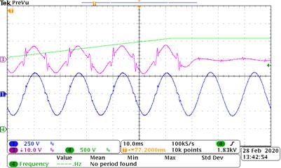

Hello, I started to use UC3854ADW from 2000 in many of our products for Power Factor Correction. The power range is from 500W to 5KW in a single phase power system. In the past 18 years, the input current waveform was nearly perfect, it is almost the same shape of input voltage, and the quality is very stable.  However, recently, the input current waveform was distorted when we compare with the controller UC3854A  made before 2018. The Power Factor is dropped sharply after 2018. We see spikes when the current happened at zero crossing(Figure 1). The harmonic current is over the limit of 1000-3-2 class A. We confirmed if UC3854ADW made before about 2018(do not know the exact date), the input current was  perfect(Figure2). I would like to know if TI changed the design/process recently. And if other customers have the same complain.
Figure 1: Channel 3 purple current has large spike at zero current crossing. The PFC controller at this figure was made in 2019.
             Ref:   Channel 1 is AC Input voltage at 220V.  Channel 3 is AC input current.
Figure 2: Channel 3 purple waveform is the input current has no spike at zero current crossing. The only difference is the chip UC3854A was replaced from the newer date code to the old date code one(2014). All of the rest components are the same.
  • Hello Hong,
    Its hard to say what is happening without being able to review the schematic.
    At the zero crossings the controller has difficulty matching the current amplifier output with the multiplier output.
    This is because the voltage across the inductor is very low and so the converter is unable to deliver the required current demanded by the multiplier.
    This results in the current amp saturating.
    Once the input voltage rises high enough the current overshoots because the amplifier is saturated.
    This may be causing the spike around the zero crossings.
    The current recovers when the amplifier comes out of saturation.
    So thats what I think may be happening. If you post the schematic with the component values I may be able to offer some more help.
    Please post as a pdf attachment since it is impossible to read an embedded image.
    John

    Do you have a chance to review the schematics I posted ? My PFC operating frequency is 42kHz. The PFC choke inductance is 600uH. All values in the schematic are exactly follow up your design instruction sheet.
    As you mentioned above, the zero crossing distortion occurs just after the AC line input has crossed zero volts. At this point the amount of current which is required by the programming signal exceeds the available current slew rate. When the input voltage is near zero there is very little voltage across the inductor when the switch is closed so the current cannot ramp up very quickly so the available slew rate is too low and the input current will lag behind the desired value for a short period of time. Once the input current matches the programmed value the control loop is back in operation and the input current will follow the programming signal. During this transition, the current amp may saturating then caused a spike.

  • Hi Hong,
    Sorry about taking so long to reply. I was out of the office for a while.
    Anyway I reviewed your schematic and I think the circuit was designed for the UC3854 part.
    The UC3854A does not require a DC offset on the ISENSE pin.
    In your schematic you have 30mV on this pin. This will cause the current amplifier to saturate low around the zero crossings.
    When the CA comes out of saturation it overshoots and I think this is causing the spikes in your waveform.
    Please remove R38 from your pcb assembly and retest.
    Let me know how you get on.
    John
  • Hi John,
    The suggestion for removing R38 does not work. I removed R38,  the zero cross spike  is still there.
    However, I am making progress by double the Iac current which seems help.
    I think at the data sheet of UC3854A page 8, the recommended Rac value1.53M is not optimized.  I found Rac is very important for  this spike. Our current design is based on Rac=1.53M ohm which limits the Iac < 250uA at high line. According to TI application note Slua263 page 2, it says sometimes, the Iac is desirable to increase the current as high as 500 uA. To do so, the Rac should be around 750k ohm. With this change, I can get very good input current waveform without this spike. Can you please double check which recommendation I should follow up? If 500 uA is needed in order to get a better signal to noise ratio, I suggest TI to update the official data sheet.

  • Hi Hong,
    I understand. But this,together with the DC bias on the current amp input , is another example of the UC3854A being operated in an characterised environment.
    Without a proper signal on ISENSE+ and ISENSE- it will be very difficult to generate the correct pwm pattern
    There seems to be a lot of filtering on the current sense input and it may be that this signal is getting corrupted before it gets to the controller
    There are also zener diodes on CAOUT and PKLMT.
    These parts were used with the UC3854 but are not used on the UC3854A.
    John
  • Hi John,
    I removed all additional components around ISENSE+ and ISENSE and those Zener diodes. All do not affect the spike of  AC input current. Again, reducing Rac value to increase the Iac current,  and adjust Rmo value accordingly  can improve the input current a lots.  Did you have a chance to read  TI application note Slua263 page 2?
    Hong
