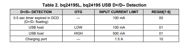

  • HI,
    How are the D+/D- and OTG pins connected? What is REG08b[6:7] reporting? From table 2 on datasheet page 14, the input current limit can be limited to 100mA or 500mA for a detected SDP port if OTG is high or low.

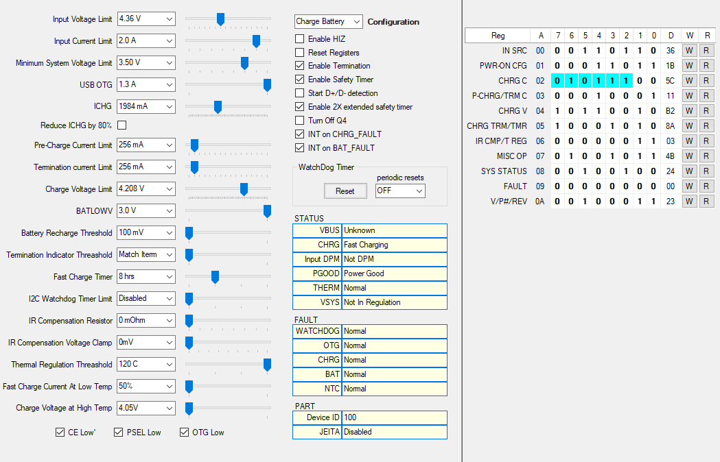

  • Thanks for all the help so far, Jeff. Unfortunately I'm still not able to get the charger to the current levels I'd expect. Could you perhaps take a look at this register dump? This is charging from a Samsung 1.5A charger, using a USB-A to USB-micro cable. Battery is at 4.0V, charge current is 350mA, and system current is 3mA

    I took your register settings and input them into the BQ24195L software and here is the screenshot of it for your reference. I noticed that in your status register 0x08, it shows that your device is in DPM regulation mode. I'm not sure if it is regulating the input current (IINDPM) or input voltage (VINDPM). Could you measure the input voltage at the VBUS pin and let me know what voltage you see? This will help determine if it's in VINDPM or IINDPM.

  • Hi Hari,
    VBUS was sitting 4.35V. I increased the power supply to bring it up to 4.8V which produced the below registers but no effect on charge current. I'll get that EVM tool and see if it'll help me debug too.

    Were you able to ensure that there was no communication on the shared on the I2C bus after power up? I see that in the Reg 0x08, it still shows that the VBUS is unknown. If you see the Table 2 from the datasheet below, it will clamp the current limit if bits [7:6] are 00. Also, what is the battery voltage that you measure? Could you please measure this voltage at the BAT pin of the IC and also your input current from the charger? As for the charging, how are you measuring the low charge current going to the battery?
