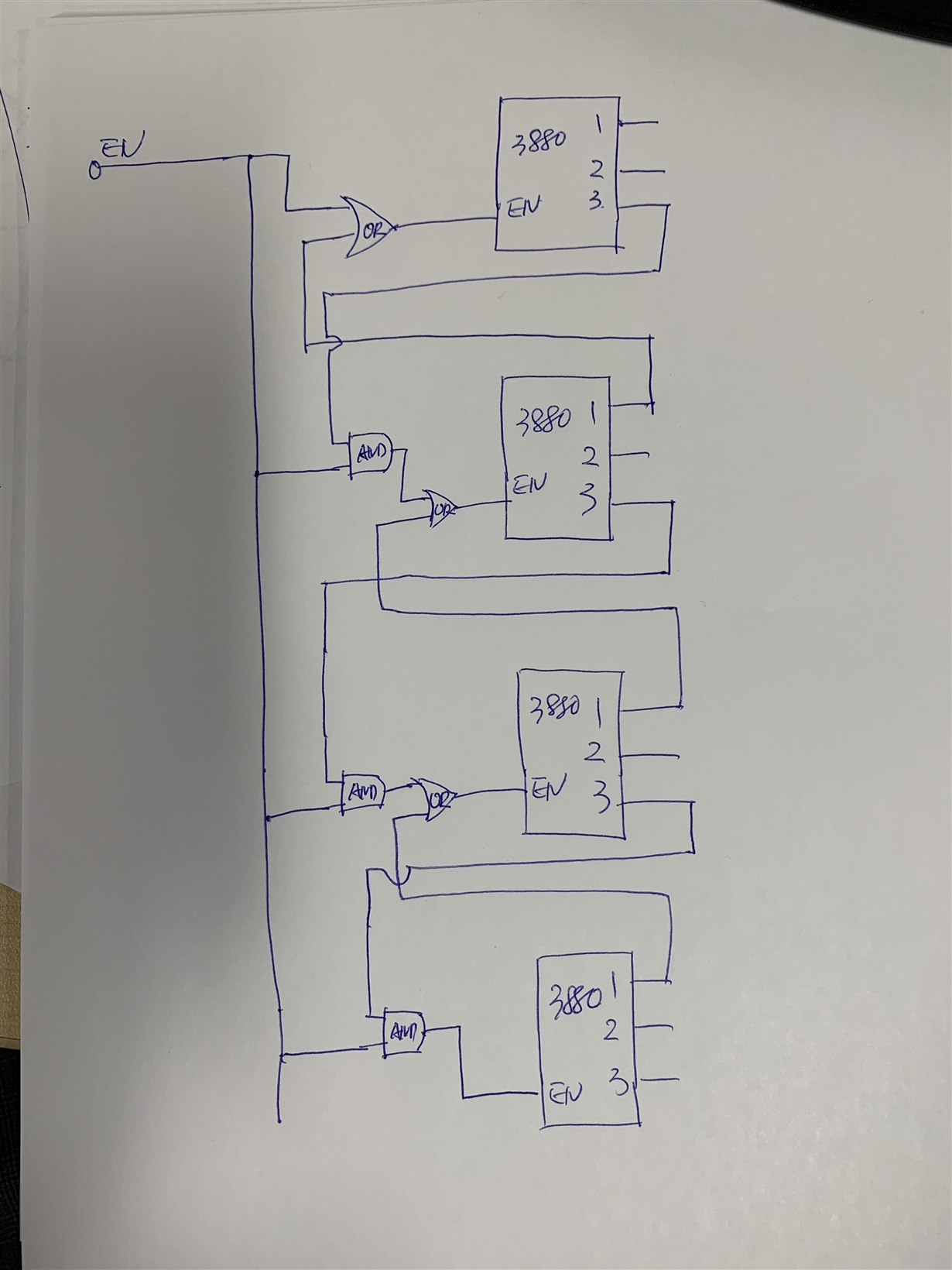

Power Down Sequencing has to be implemented in Xilinx RF-SoC custom design.
There is no timing requirement between the power rails.
Please provide suggestion/idea in this regard.
Khushboo
Hi Khushboo,
You can use below link to search the sequencer for your application.
Qian
Hi Yihe,
We need to sequence total 9 rails.
We don't need margining and monitoring.
Also we have a single 12V supply therefore it will be difficult to do sequencing using a down sequencer like LM3880
wherein we need a separate supply out of the sequencing chain to power on the LM3880.
So request you to suggest some alternatives.
Khushboo

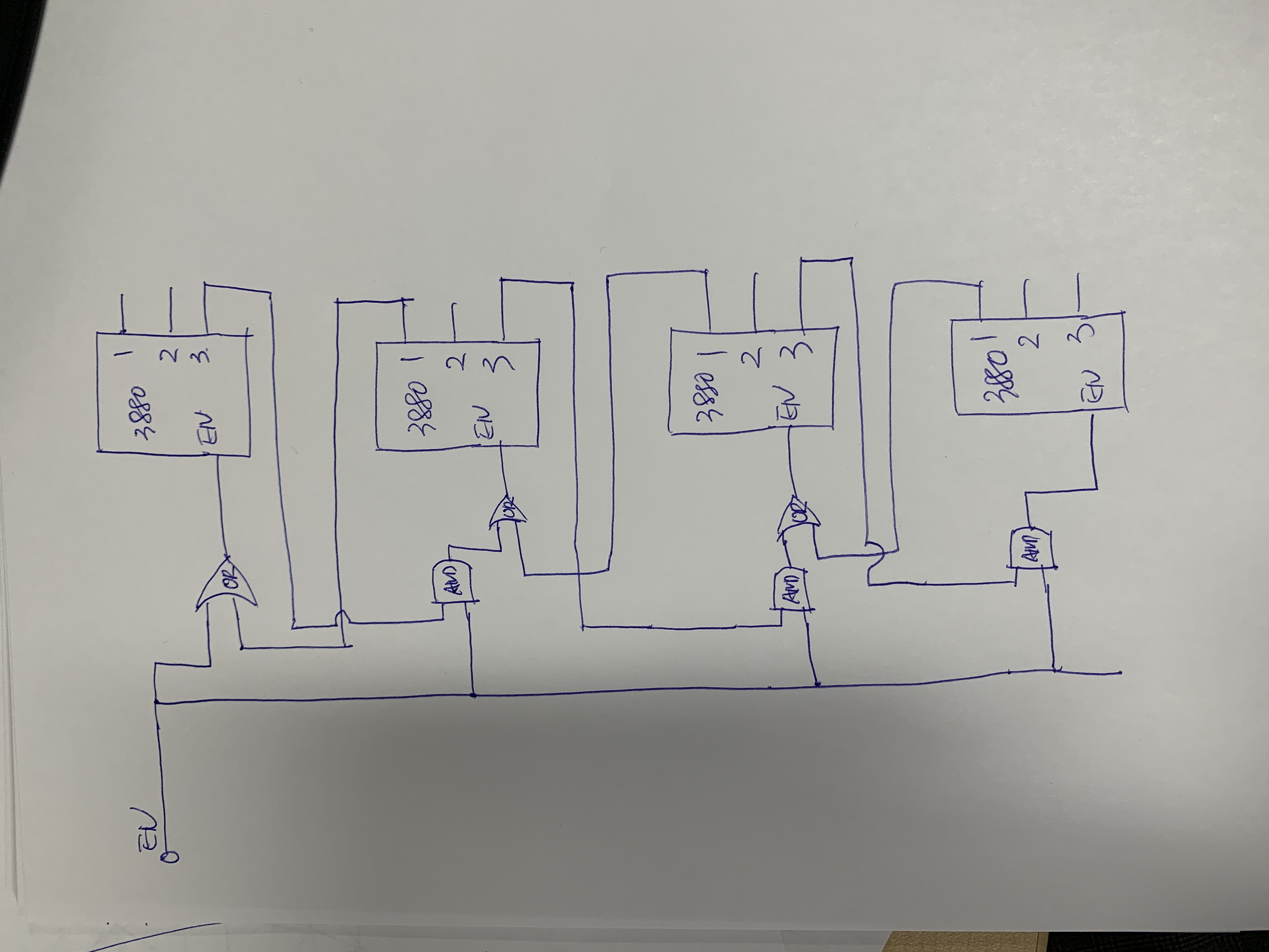

Hello
LM3880/1 are the two products which support sequencing only. the rest UCD90xxx product do sequencing, margining, monitoring.
I would recommend UCD9090A to meet your need.
But LM3880 also works. you can cascade 3xLM3880 to achieve the 9 rail sequencing.
Regardless UCD or LM388x, a separate power converted from 12V is need.
Yihe
