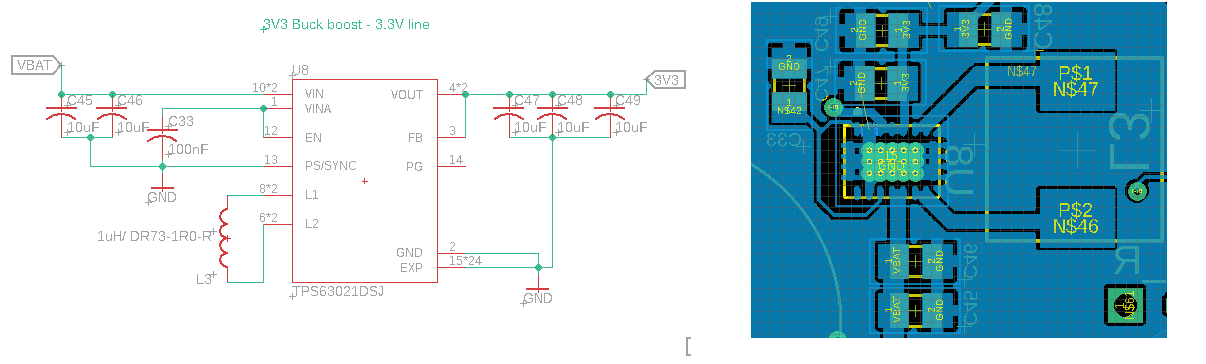

TPS63021: Need help reviewing Buck Boost design for TPS603021
Part Number: TPS63021
The following are the design parameters
Vin: 3V to 4.2V (Li Ion Battery)
Vout: 3.3V
Iout: 600mA
Following is the schematic and PCB design . Need a review for the same.
Thanks!
Milind

  • Hi Milind,
    Thanks for reaching out.
    The schematic looks fine. For the PCB, you need to do the following changes:
    1. Add more GND vias close to the GND ends of input and output capacitors C45-49.
    2. Connect the GND end of C33 directly to the GND pin of the TPS63021.
    It is important to have as small as possible GND loops between the input/output capacitors and the IC. I have left some links with PCB layout guidelines in your previous thread.
