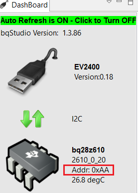

BQ28Z610: I2C slave address of BQ28Z610
Part Number: BQ28Z610
I asked a question about BQ28Z610 I2C slave address in below page and got the answer: 0x0b (7-bit).
https://e2e.ti.com/support/power-management/f/196/t/890918
However, we heard different information from the battery pack vendor. He said that "the BQ28Z610 uses a series of 2-bytestandard I2C commands with a 7-bit device address of 0x55 (8 bits = 0xAA to write and 0xAB to read)."
Can anyone confirm which answer is correct?
