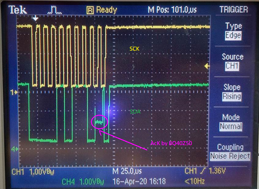

       My customer recently encountered a problem. They try to communicate the gauge IC BQ40Z50 by Apollo lake SOC through SMBus.

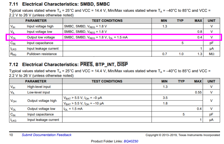

       They found it received the read command and responded acked but it seems the sink capability is not enough to pull down the voltage at SDA to under 0.4V.
       This caused SOC failed to transmit the other commands.
    The internal pull high resistors in SOC is around 20Kohm.
   Would you kindly give us some directions?
