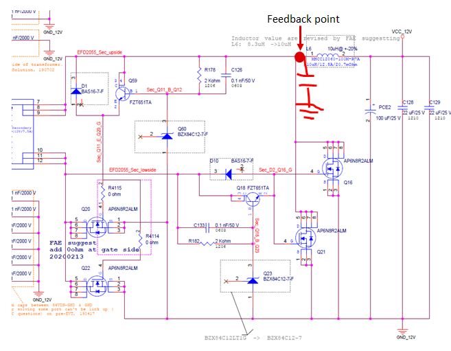

Hi Team,
Below is secondary side for UCC2897A. As I know L6 is filter of output side, but should I add large cap in front of L6? And feedback voltage should be in front of L6 and behind large cap if I add the large cap. You could refer to second image. If we don't modify the schematic, the schematic transfers to 3rd order circuit. Will it cause large unstable factor?
Roy
  • Hello Roy
    The first schematic is correct.
    A forward type of converter requires an inductor followed by a capacitor on the secondary side of the forward transformer.
    The purpose of the inductor is to limit the current into the capacitor.
    There is no reason to have a capacitor as shown in your second drawing.
    John
