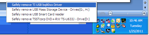

    Did you have any issues with the EV2300 driver installation?
    Do you see the bq80xx driver loaded in the lower right hand corner (see attached image)?

    We had no problem in installing EV2300 drivers.

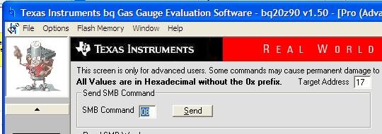

    At very first time, when we connected the evaluation module to PC communication was established. We were able to export .gg files also.
    At that point of time, we updated the firmware in the srec programming screen in Pro screen. Do this updating of firmware erases any information in the evaluation module? What is .senc file ?
    Raghu
  • Hi Raghu,
    Now that you tell me about the firmware update, what I think happened is this:
    when you reprogram the firmware you need to:
    1. in "PRO" screen put the gas gauge into ROM mode by writing SMB Command "00" Word "0F00".
    2. reprogram the gauge with appropriate .SENC file
    3. Then you will get a warning to close EVsoftware >>>>  BUT before you do..... you need to send SMB Command "08".  Simply press the Send button in image shown below.
    4. close evSoftware and reopen (so new dataflash parameters will load based on your .SENC file programmed)
    It's not too late.  All you need to do is open EVsoftware ... ignore all the warnings ... get to the PRO screen ... and send the "08" SMB command.
    I hope this solves your problem.  Best regards, Keith
  • Hi sir,
    We have followed your instructions.
    It is working now.Thank you for your support.
    Raghu
