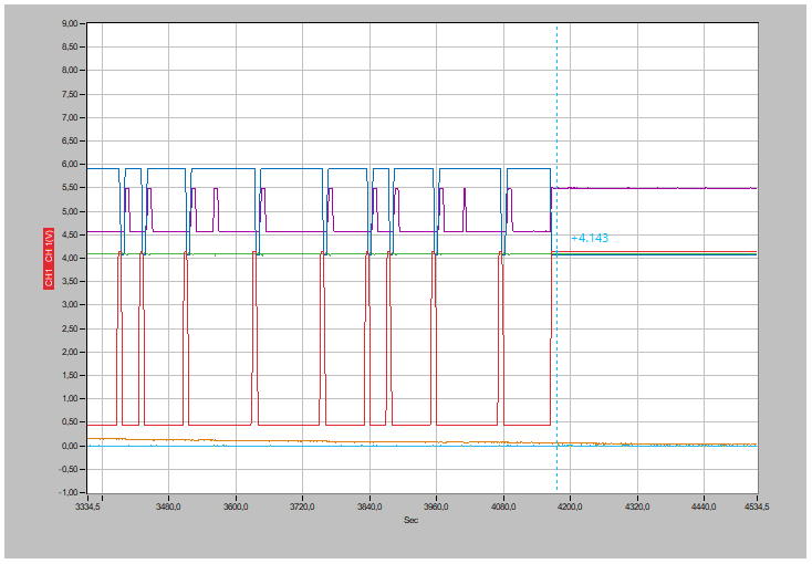

Now I am checking balance operation but I met promblems: the balance procedure started but after expering certain amount of time it has stopped, thus the cells remained in unbalanced state.
I used mult-channel analog signal recorder for this test. I made two test: one did utilize only minor initial unbalanced condition, second used larger (allowing to raise OV event-> CFET turned off).
Charger setup. CCCV by PSU: 1A, 12,3V (3*4,1V, because '77915-00 variant has OVD=4,200V, Vfc=4,100V). Jumper in CBI state on EVM.
Somebody could suggest idea why stopped the balancing? Unfortunately the datasheet does not detail the stop conddition neither Vcbth nor Vcbtl (abs) levels, only a 100mV hysteresis mentioned. From my experiments, it seems balance starts at 4,1V (pls see ath pictures).

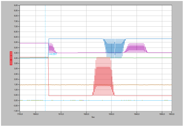

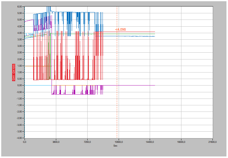

Graphs: CH1 RED: Lowe cell, CH2 BLUE: Middle cell, CH3 GREEN: top cell, CH4 PURPLE: CFET Gate, CH5 Orange: signal on current sensing element. Note: channels 1-3 are connected to
RINs lower pad (IC VCx pins) thus when balance ON the measured voltage value corrupted...but it is not so important, I wanted to see how switching. When balance OFF: measured voltage values became again correct for the analyzer.
Minor initial unbalance, sample rate: 200msec (max speed). Before turing ON charger, cells are: 3,763, 3,703, 3,712V
Magnify : it is corresponding to datasheet which states the BQ applies 200ms balance-test interval
End: by the end cells: 4,143, 4,069, 4,093V
with Larger initial unbalance: cells: 3,706, 3,508, 3,620 before turning ON charger
It can be seen, CFET also turns OFF (top cell reached the OVD level)
By end of procedure: 4,098, 3,748, 3,921V thus highly unbalanced
  • Hi Joseph,
    Thanks for providing excellent details and waveforms to describe your issue! The cell balancing feature can be very confusing since it is a fixed hardware state machine algorithm.
    The key parameters that are fixed based on the device number (see Section 6 Device Comparison Table in the datasheet) are VSTART, VHYST, and VSTEP. For the BQ7791500 which is used on the EVM, these are set to 3.8V, 100mV, and 100 mV.
    This video may help explain why you do not see the balancing turn on until the cell voltages reach 4.1V. It may be that you never have cells that are below VCBTH and VCBTL at the same time. Once the cell voltages cross VFC, then the balancing behavior changes and all cells above VFC balance. Balancing will stop once the charge current falls below the current state comparator hysteresis. The behavior changes again when a cell has gone above VOV.
    https://www.youtube.com/watch?v=wewL0oJRBNM Youtube
    https://training.ti.com/how-cell-balancing-feature-works-bq77915  ti.com
    Matt
