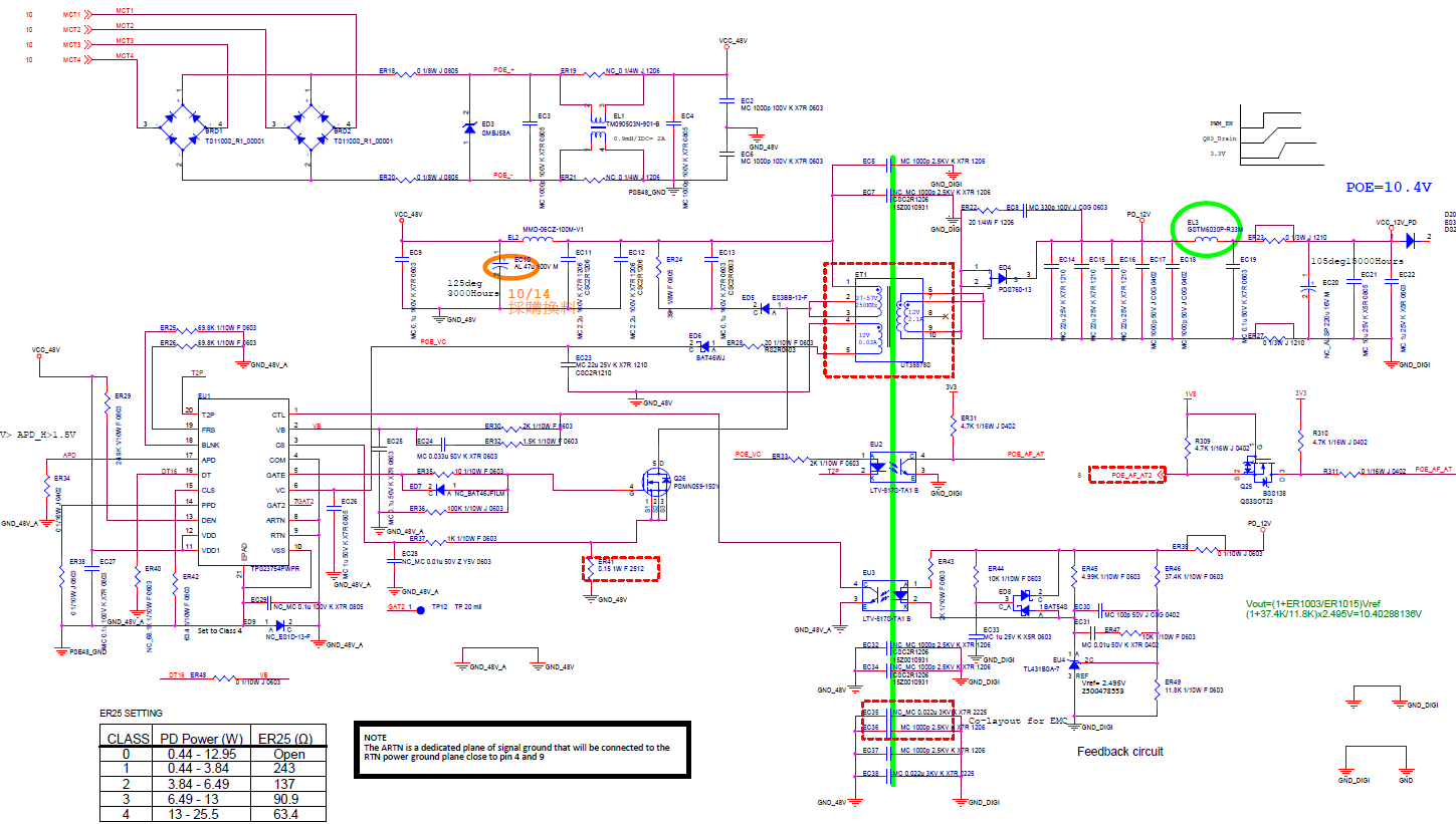

Dear Team,
If I want to cost down below reference design, do you have any comments?
I can find TPS23754 change to TPS23751 will be a good point, anything else?
BR
Kevin

  • Hello Kevin,
    Yes changing the TPS23754 to the TPS23751 is a good cost saving step.
    If you are looking for a Class 4 10V (down from 12V) design, I would look at the PMP11254.
    https://www.ti.com/tool/PMP11254
    This design is a diode rectified flyback, it does not have the output inductor nor any electrolytic caps on the output. It also has a smaller input bulk capacitance. You could alter the design to be 10V.
    Otherwise the components to look at are the inductor, the FET, the diodes and the transformer.
    The key with the diodes is the reverse recovery time and the power levels.
    The key with the FET is ensuring the VDS voltage rating and current rating is high enough (usually 150V / 3A).
    I would strongly advise NOT changing the transformer since so much of the DCDC is based on the transformer. However, people do it and it probably will have a noticeable cost difference.

    we are also using PMP11254 as the basis for a low cost TPS23751 design. We have also changed the transformer against LinkCom LDT8202-51R.
    Question: What is the allowable input voltage range for adapter supply? PMP11254 is rather limited form 41 to 57VDC. We would want to get to 24 to 57VDC.
    MIchael
  • Hello Michael,
    Per the schematic label on adapter input J5, it can be seen the input voltage range is 41V-57V.
    A class 4, 12V output design with adataper voltage 21V-57V is the PM8812.
