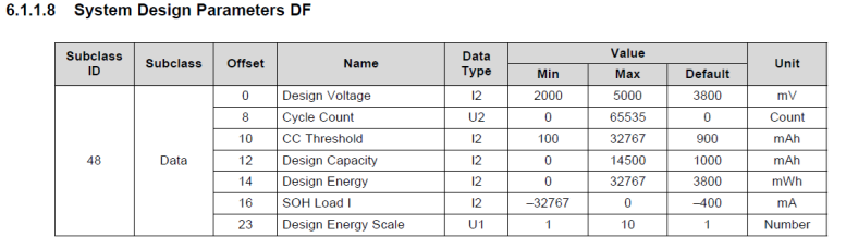

BQ27542-G1: Max of FCC?
Part Number: BQ27542-G1
Hi Team,
May I know the max FCC (mAh) limit of BQ27542-G1?
If the design capacity is greater than 14500mAh, can it be adjusted proportionally (eg * 10 or / 10), so that the battery capacity greater than 14500mAh can be applied?
Thanks and best regards,
Jamie
  • You could divide all capacities by 10 and configure the current measurement (combination of sense resistor and/or calibration CC Gain) to measure 1mA for a true 10mA current.
    Make sure you run a learning cycle with these settings so that the gauge learns QMax and impedance accordingly.
