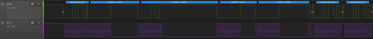

I'm using a BQ34Z100-G1 and a microcontroller to monitor a NiMH battery.
I'm now testing the recovery mechanism. I'm using an analog switch (STG719) to route P4 to P1 or to the I2C line and a 3.6V voltage regulator with enable (TPS70936) to be able to control the recovery mechanism with the microcontroller.
1) If the BQ is working well can i switch to ROM mode using the recovery mechanism?

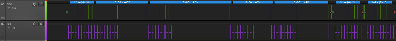

2) Trying to switch to ROM mode with the recovery and watching the I2C bus with a logic analyzer i've noticed that the BQ reply to the ROM mode address only sometimes, and when ti reply i can be able to send only some bytes befor reciving a NAK and lose connection with it. Is this a correct behaviour? Have i to send some specific command to keep it in ROM mode?
Here there is a screenshot of the logic analyzer, this happend about 250ms after power up.
Lorenzo
