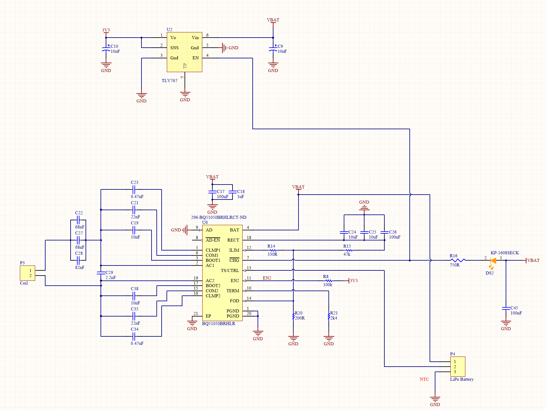

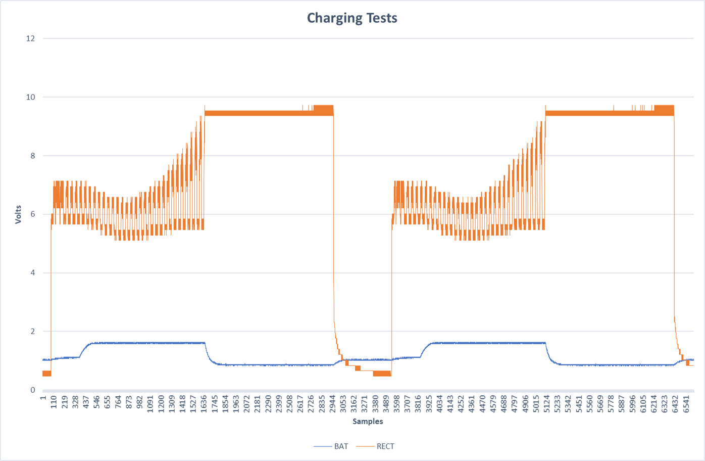

I'm testing my latest prototype using the bq51051b device and have encountered a problem with a low voltage battery, please see below traces for RECT and BAT pins, RECT seems very high and I'm not sure what is causing the issue, the CHG light is very dim also, any assistance of what the issue is I'd be very grateful. Circuit used also below, I'm using a 760308101309 coil from Wurth.
