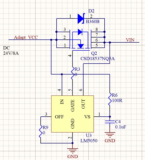

Hello;
I tested LM5050-1 at light load mode,VGS only 1.7V ,
When the load 2A or 3A...,The voltage of VGS is zero and the current flows through D2,
I wonder if the output has no capacitance or what's the problem?
TKS!

HI
At no load or light load, Vgs can be low, actually close Vth of the MOSFET used.
Vgs will increase as the load current is increased.
Can you share the schematic used?
I could not refer to the diode D2 you mention.
Kari.
Hi
When 2A is taken from VIN side, Vgs should not be 0V.
Can you share some waveforms showing Gate, IN and OUT and current?
Can you please check if the MOSFET is not damaged.
Kari.
