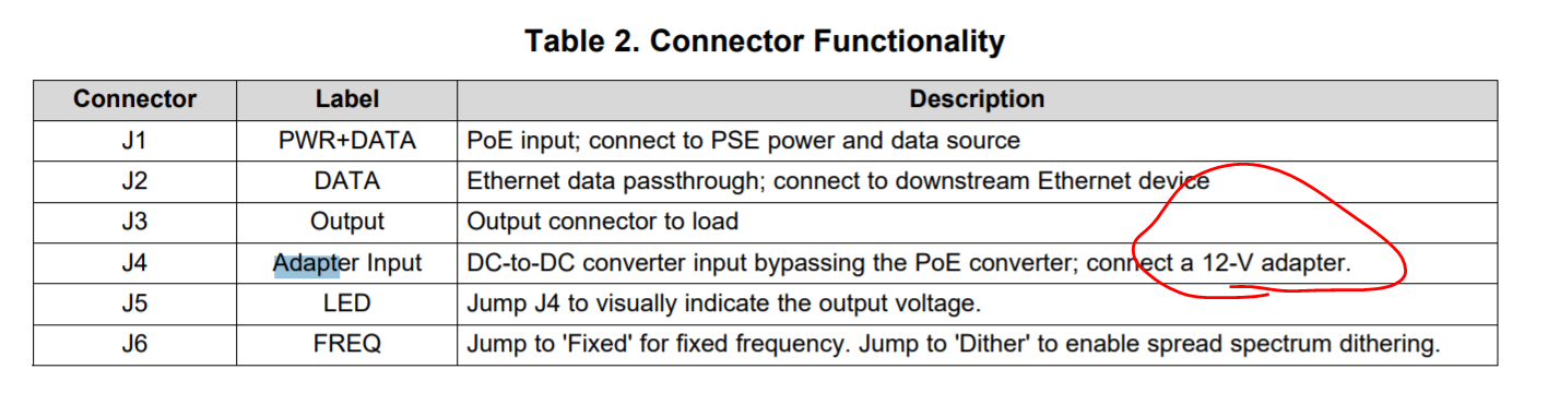

Dear Team,

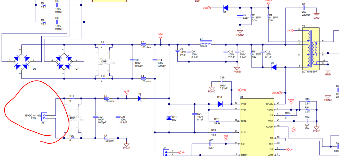

I am not sure this EVM's adapter is 48V or 12V.
It should be 48V right?
Please check it is a typo or not.
If it is for 48V adapter priority, do we have a workaround to have 12V adapter here?
Customer is considering this 5V EVM design, but the adapter will be 12V

    Thank you for your question! Yes this is a typo. If we look at either the schematic or Table 1., we find the Adapter input voltage is 48V.
    I think this is here because the TPS23755 was developed at the same time, and it looks like this table was copied but the 12V adapter part was not changed.
    Thanks for pointing that out, we will look into getting it changed. Thank you!
