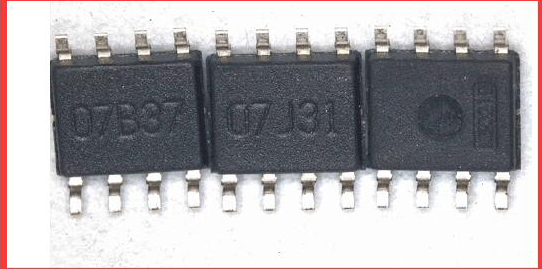

is there a possibility three different parts marking in the tape of reel.
which one is an old version?
customer said that the parts below are in one tape.
I think it's impossible.
Thanks in advance.
Hi Mark,
Please ask the customer to look at the topside of the package for the top mark or symbol.
The photos are the bottom of the package and it shows the mold cavity marking which can vary due to the mold chase used in production.
