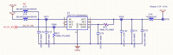

May I ask whether this SCH is ok? I found TPS735 connection is quite simple in datasheet...But customer add some bead/cap in their SCH...

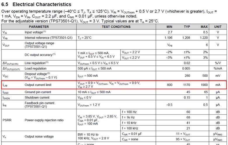

And it seems that TPS735 could output max 1.9A. In which situation, could it offer 1.9A output current?

    The ferrite beads are OK. As long as the minimum capacitance at COUT is present, the LDO will be stable. The problem I see with the schematic is R21. R21 and C56 setup a low pass filter which will likely result in the regulator oscillating. What is the reason for this RC filter? Normally if they want to regulate to 1.2V you simply short FB to VOUT
    The output current limit shows where the current limit could engage. Meaning in the extremes it could be as low as 800mA or up to 1900mA. This current limit is present to protect the LDO and not the load. The LDO has a second tier of protection which is the thermal shutdown. if there is a short at the load, the voltage across the LDO will increase and the (VIN-VOUT)*ISHORT power dissipation will increase. This increased power dissipation will result in thermal shutdown.

    Customer is also a little confused about current limit in datasheet. When it is in a fault state, it will output a specific current value.
    What is this current value? Is it directly output to the load?
  • Hi Amelie,
    你太客氣!
    The current limit is a secondary and slower regulation loop than the voltage regulation. This is because the primary goal of the LDO is to regulate the voltage. Because the current limit loop is slower, where it trips is not a precisely tuned threshold This is why the datasheet shows a wide range.

    When I talked again with customer by phone, I figured out why he is so concerned about current limitation.
    They use TPS735-Q1 to convert 3.3V to 1.2V and the load is just FPD-Link DS90UB948.
    TPS735-Q1 max current is 500mA and the load FPD-Link max current is 230mA.
    They has SOP the head unit project,however, found one of the head unit machine failed.
    The output of TPS735 is only 0.5V, not 1.2V. The problem is on the bead (L16), the ferrite bead is damaged and the resister became large which may output voltage is 0.5V.
    When customer consult the  bead supplier, the bead supplier said the bead rated current is 500mA, if the current is higher than 500mA, this bead will be damaged for sure. So it is because LDO's current is higher than 500mA without current limit...
    To be honest, I don't think customer need to add bead in the output. May I ask whether there is risk (EMC...) if not adding  L16 bead?
     Have you ever heard about the similar issue? Output voltage is abnormal because bead is damaged. How could we give some advice?
    Thanks!
  • Hi Amelie,

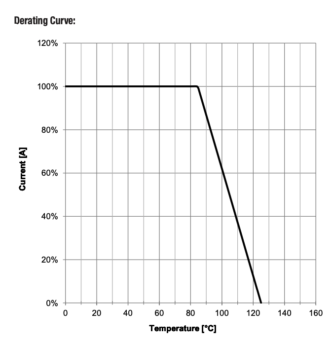

    I found the datasheet for the ferrite and it has a DC resistance of 0.32Ohm. So at 230mA, there could be ~73mV dropped across the bead. The bead itself is only rated to 85C. at 125C, the datasheet clearly shows it can support no current.
    If the bead is damaged, then its properties change and it could become more resistive. Can they either remove the bead or switch to one rated for a higher temp/current?
    Whether or not the bead is needed is really up to the application. It is quite common to use ferrite beads as shown in RF applications as they will help to block noise frequencies >100MHz.
