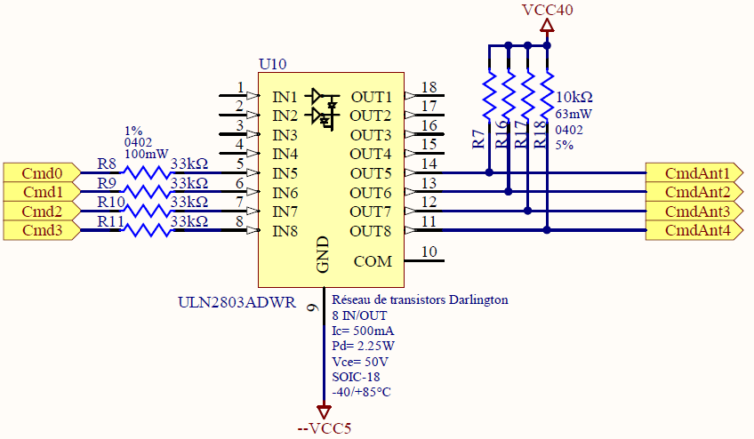

We use the ULN2803A as a signal switch and I am wondering if there is not a problem with a particular lot.
The inputs of the component are controlled by a basic microcontroller and the outputs are switched between two voltage levels (a low level connected to GND pin, and a high level 40V connected to pull-up resistors on each outputs).
We have been using this component for years and we are facing now the following issue : After several minutes, the 40V levels decrease on the ULN2803A outputs and lead the board to reset after a current rise which comes with the 40V decreasing.

  • Hi Andy,
    Would you be able to share a schematic of the ULN2803A portion of the system?
    I can only share this portion of the schematic with you. The CmdAnt go to each diode through a resistor and a LC circuit which cuts the RF signal frequency.
    Cmd0 to Cmd3 are the microcontroller's outputs.

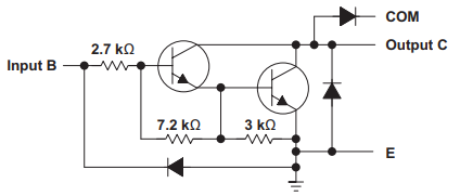

  • Hi Thomas,
    I just wanted to let you I'm still looking into this, but do have a question for you. What is the input that is being applied to the Input B node of the internal schematic of the ULN2803A that you shared in your last post? This would be the same the the input on the INx pins of the device.
    Just to confirm, the input on E from your schematic seems to be 5V. Is input B sometimes lower than E in your schematic in one of the states?
    Andy Robles

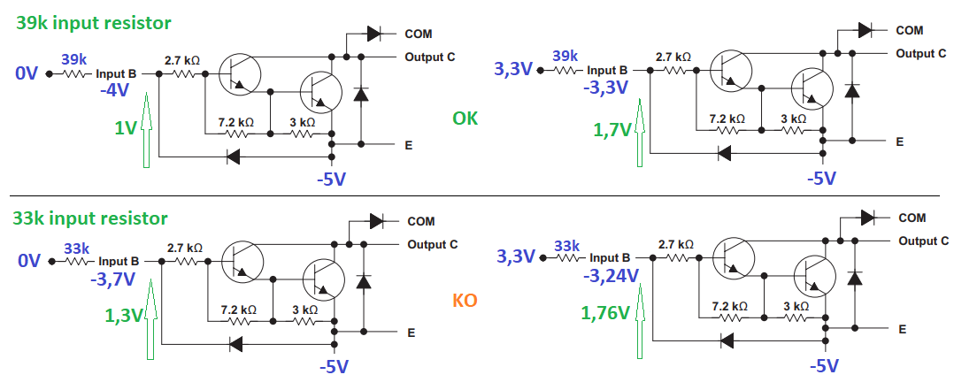

  • Hi Andy,
    Thank you for letting me know. I have some new information after doing some measurements. Here is a picture to summarize them. Note that the voltage level on E is -5V (and not +5V).
    The board works well with the 39kOhms input resistor and we have the issue (sometimes) with the 33kOhms input resistor.
    I guess now that, with 33kOhms input resistor, the current differences at the input was not sufficient (considering the two input voltage levels 1,3V and 1,76V). And 1,3V was too high to produce a low level current.
    Do you confirm that? Note that I resumed that design after the departure of a colleague.

  • Hi Thomas,
    Just to clarify, are the values in green values that you were able to measure from the boards?
    Judging from the values observed, your reasoning does make sense. Unlike other devices in our portfolio made of MOSFETS which will have a strictly on or OFF state, the ULN made of BJT's may experience a state where the channel could be partially on due to the currents at the base. Device variation from manufacturing could be causing some of the devices to work with the 33kohms resistor, but with the 39kohms resistor the voltage will be pulled low enough to enable all the devices to work. I would suggest keeping the 39kohms resistor in the design to ensure the functionality of all devices.

  • Hi Andy,
    Yes, absolutely, I measured the green values directly from the board.
    Thank you for your advice. I will try now to find how exactly our 1,7V is far from the VI(on) limit. I guess it's somewhere close to the 1,3V, but I need to know if there is an hysteresis effect or no.

  • Hi Andy,
    Excuse me for the delay. I did a last set of measurments and it appears that with the 91WK28B batch (the one with which I discovered the problem) the transistor starts to conduct above 1.47V. And it's 1.52V with the 82ZD6V4 batch. Moreover, as I had 1.43V as low-level inputs with the use of the 33kOhms resistors, I was too close of that value of 1.47V. With 39kOhms, low-level inputs are at 1.041V, that's why it works better.
    About the hysteresis, I understand that this component can't have this kind of effect.
    Thanks a lot for your help and the time spent answering me.
    I consider that the problem is solved.
