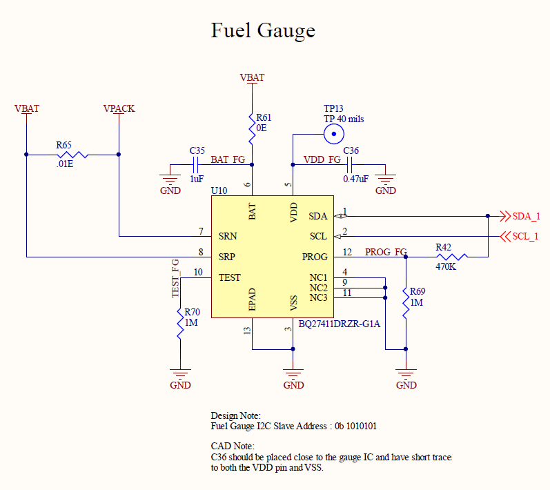

Hi All,
We are working on a Handheld battery-powered medical device that uses a 900mAh Li-Ion battery. We are using the TIs BQ27411DRZR-G1A fuel gauge for battery monitoring. We would like the design to be reviewed by the TI team. Attached the snippet of the schematic implementation. Could you please review our design & provide your valuable review comments.
Thanks in advance!
