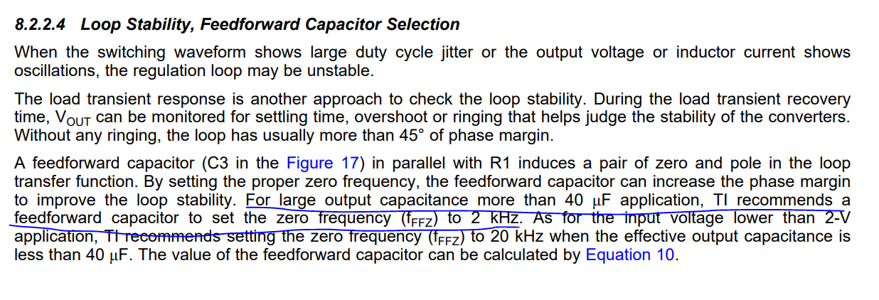

    For the schematic and layout, below are my comments:
    1. The 2.2uF ceramic capacitor C11 is suggested to be placed close to TPS61022 Vin pin to filter noise. This is just a suggestion but may not be the root cause. Please fix it in next version layout.
    2. For a single super capacitor application, as the super capacitor voltage decreases from 2.7V down to 0.8V until triggering TPS61022 switch current limit, TI suggest add a feedforward capacitor in parallel with upper feedback resistor R14. Otherwise there is loop stability problem.
    3. What's the inductor L1 saturation current spec? TPS61022 employs valley switch current limit 8 A typically. The chosen inductor saturation current spec is better higher than 10A.
    Below is the tips of debugging:
    1. Firstly make sure during the second charge, the board other circuits are working correctly. No over voltage happens and applied at TPS61022 pins.
    2. Like the 2nd comments, Solder R17 with a 2kohm resistor, Solder T6 with a 1nF feedforward capacitor. So that the zero frequency (fFFZ) is around 2kHz.
    3. Try to capture the key waveform during the second charge, for example, high voltage at Vout pin, Vin pin.

  • Solder R17 with a 2kohm resistor, Solder T6 with a 1nF feedforward capacitor. - SOLVED PROBLEM
    Thank you.
