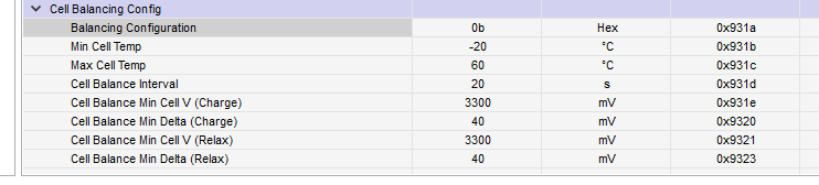

we want to use the bq76952 in standalone mode for a 16S6P (21,6Ah) LiFePo application.
So far we have designed and produced a first PCB version.
How can I activate the cell balancing function?
I have made following settings:
Cell7 runs in COV-Protection (3750mV).
The other cells were around 3600mV.
But the bq76952 does not start to balance.
Thanks for helping us.
