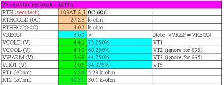

Hi Sir,
Pls advise what are the values ​​of VT1 and VT5?  VT1= 5*0.25、VT5=5* 0.125 is right??
If temperature setting range is 0~50 °C, please check below resistor value is correct?
Note .  There are two sources of NTC
Vin
5
Vin
5
RTHhot
4158
RTHhot
4160
RTHcold
27280
RTHcold
27218
VT1
1.25
VT1
1.25
VT5
0.625
VT5
0.625
RT1
19623
OHM
RT1
19642
OHM
RT2
8604
OHM
RT2
8621
OHM
CHIP 19.63K OHM 100PPM +-1% 0402 KOA L (19.6k)
CHIP 8.61K OHM 100PPM +-1% 0402 KOA L (8.66k)
Thanks, Ian.
